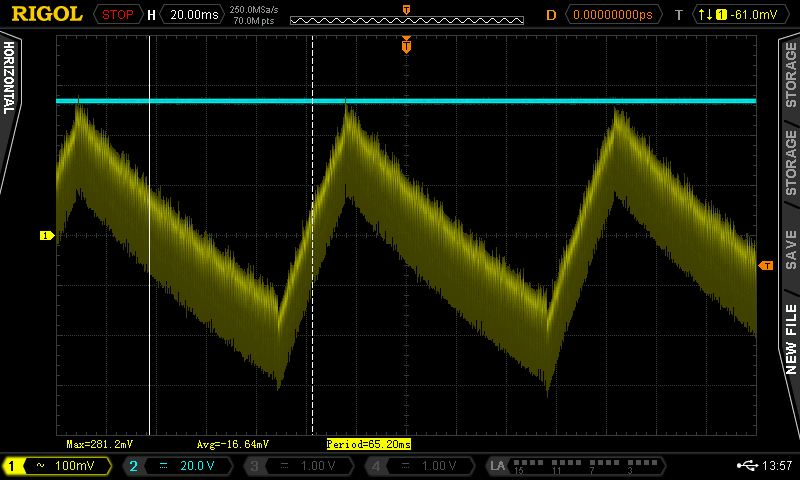

The charge pump operation is intermittent. This is related to power-up (connecting battery or bench supply to the BAT side of the circuit). Once connected and functional it appears to run with no problems. The intermittent refers to the initial connection. If I cycle power on the BAT a few time and get it to come up, it works and continues working.
Cap at VDDCP is 2.2uF/25V to provide sufficient capacity for 8ea CSD19536KTT FET's. Filter is 100ohm/.01uF. 75V Zener to protect part.
Battery operates 45-60V, testing at ~52V as described below.
I reproduce the problem as follows:
Connect BAT (with all BQ76200 signals low). Pull CPEN high, monitor VDDCP, leave all other control signals low.
- Sometimes the charge pump generates ~1V (so VBAT + 1V). In this mode it is a steady 1V, no charge pump waveform. Enabling CHG or DCHG makes no difference.
- Sometimes the charge pump generates 10V (so VBAT + 10V). In this mode the charge pump sawtooth waveform rides on top of the 10V. Enabling CHG or DCHG works as expected (FET gates rise ~10V above VBAT).BQ76200 Circuit.docx
I'm attaching a word doc with the schematic snippets (hope it shows).
  • As an update, I have been able to reproduce the issue without disconnecting power.
    With all control inputs low, if I bring CPEN low and back high the charge pump does not turn back on reliably.

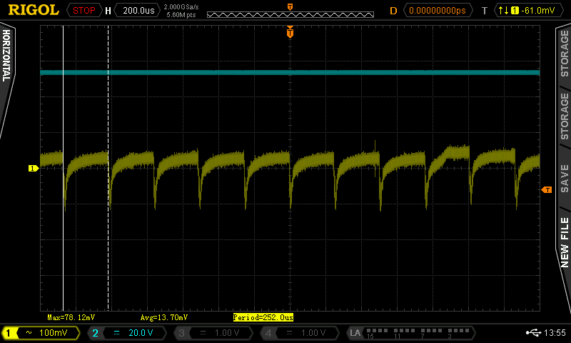

    One thing I see is ~150mV @ 250uS of noise on the power. Probably from the 5Vcc switcher on-board. I'm including a couple images of VDCCP (it looks the same with CPEN low or when CPEN is high and it doesn't come up with the exception of being ~1V higher). When it comes up it is obviously different with the sawtooth waveform riding at ~10V above VBAT. Is this level of noise an issue?

  • Hi Gerry,
    Something looks very wrong. The supply current for the bq76200 should be 60 uA plus the average load current when the charge pump runs. If you have a 2 uA load the charge pump will need about 10 uA supply current to provide it, the total current is below 100 uA, but the measurements show 15 mA with the charge pump off, 34 mA in the fail state and 1 mA operating.
    The only time I've seen high current into the IC is with the outputs pulled below VSS. You might check your connections to the board or perhaps for missing solder on the VSS pin. If multiple boards perform the same it does seem systemic. If the parts have been damaged in some way they must have all had the same process.
    The X7R is a good choice, it is a broad temp range component which should give good capacitance over a wide temperature range. If the circuit is away from heat sources you might use a narrower temp range.
    The noise seems unusual, you might check its source. If the noise is from the battery voltage (V+) with the FETs on it can cause load of the charge pump since the BAT pin is filtered and movement of V+ can cause current in D3, D4...
  • Confirming the noise if from the switcher supply for the VCC 5V used elsewhere. Better input (source) filtering on the DC/DC will minimize this to clean up BAT power rail.
