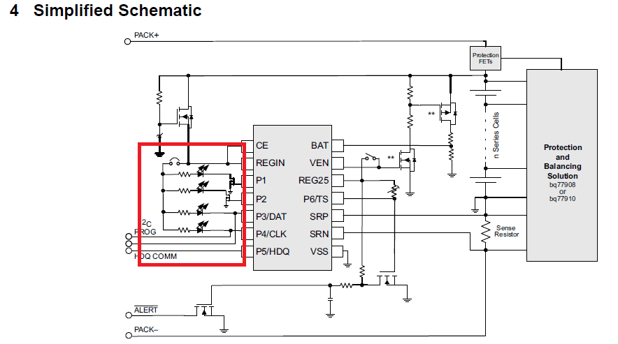

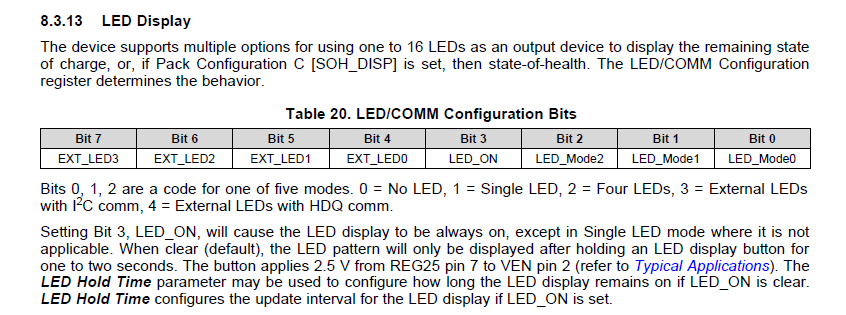

The BQ34Z100-G1 use for four LEDS, how to set the register about LED configurator? I only see "LED/COMM Configuration" as below, any other setting?
We refer to the website application. Multiplexed communication pin for LED display. The p1 and p2 pin LEDs are OK, the other two LEDs can't display.
