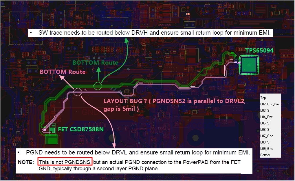

Dear Sir,
I found PGNDSNS is sensitive signal and DRVL is aggressive signal in Layout Checklist.
In intel's design 560683-apl-rvp-crb-lpddr3-ti-tdk-rev2p0, DRVL is parallel to PGNDSNS,is it wrong?
Dear Sir,
