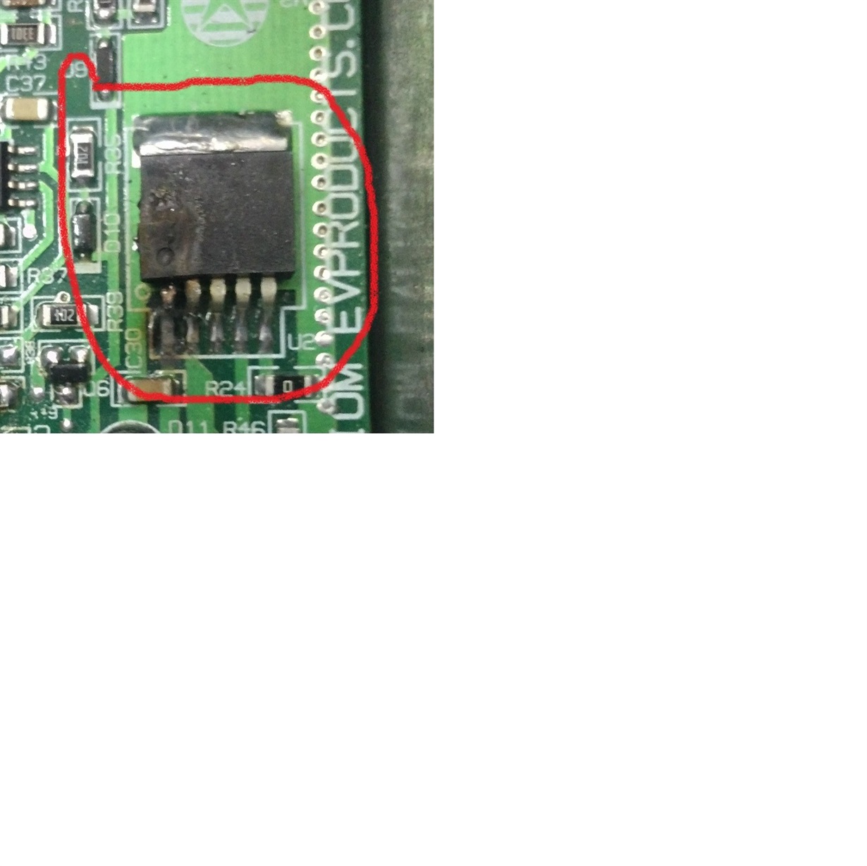

Hi
We are using LM2576HVSX-ADJ/NOPB in one of EV DC-DC converter for auxiliary supply. We have supplied around 5000 No’s to Mahindra Electric. We have not Observed any failures in development Phase and reliability tests but in field we are observing some failure  after working for 10 days in some units. Specification is as below.
 Input Voltage          36V Dc- 59V Dc
Output Voltage       14.2 VDC
Output Current       350mA
Please find the attached images and Circuit
Note: In failure we are Observing first and second Pins getting burn and showing short.
