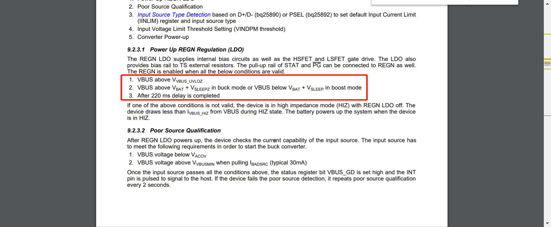

Dear Engineers,
There is a question about BQ25890. During charging, Reg00 BIT7 suddenly jumps to 1, then it get into HIZ mode. And the conditions are ALL valid.
Looking forward to your kind reply!
Robin
    The device will not set REG00[7]=1 by itself. Please double-check your I2C communication and code.
    Ning.

  • Hi, Ling,
    I have tried to change usb supply to DC power supply, and it still get into HIZ mode. Could you please help check the registers as below?

    The sample BQ2589x code is located at github.com/.../bq2589x. Please feel free to use it as references.
