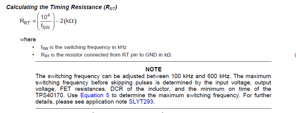

Hi team,
we have two questions want to check with you. Thanks.
1. why the devices cannot support >50% duty cycle with master mode?
2. whether the device cannot support below 100khz? And why?
  • Hello Frank,
    The TPS40170 should be able to switch slightly below the min frequency of 100 kHz, but I would not reduce frequency significantly below the minimum value. You will likely experience some inaccuracies from the RRT equation when going below 100 kHz.
    The device can support >50 duty cycle. The noise sensitivity described in the datasheet relates to duty circle around 50% and not >50%, if the duty cycle is >50% there should be no noise/jitter.
    Hope this helps?
