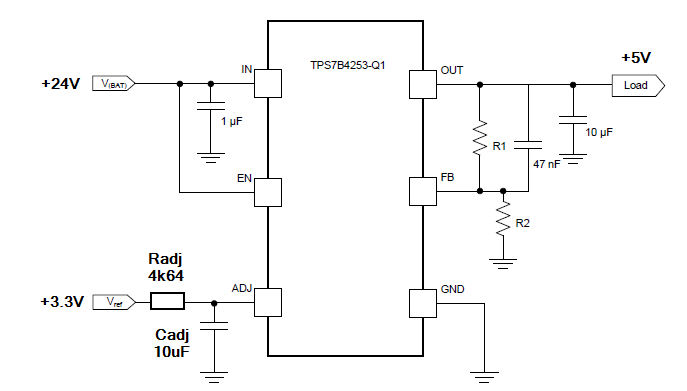

We are seeing a strange startup behavior when using the ENABLE pin while ADJ is already stable.
The setup is the TPS7B4253EVM:
TP1 (VIN) = 24V power supply
TP2 (EN) = Waveform generator, rectangle, 3.3V, periode 30s
TP3 (GND) = GND
TP4 (ADJ) = 3.3V
TP5+TP6 (VOUT + GND) = 1K resistor + scope probe

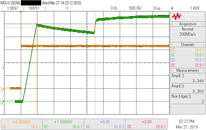

We see a rather strange ramp up of the output voltage. We'd expect a monotic ramp-up rather than what we see here:
Please advice.
