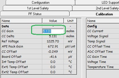

 I have an issue using bqEVSW v0.9.92 when working with DF (subclasses) menu.
Succesfully read subclasses from connected bq20z95 v1.50 device. Then go to DF->Calibration to slightly correct CC gain.
First me click on 'CC gain' field,
nothing changing me exited from that field by just clicking outside space near it,

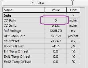

as soon as me changed focus from that field it popped up warning window stating about 'Division by zero', but it's evident the value is 5.131 and not changed,
After pressing 'Ok' the value becomes zero,
After that, me can neither refresh DF values nor export current data to GG-file as same 'Division by zer0' warning pop up again.
Exiting application and reopening it again result in same issue with CC-gain already set to zero.
When me manually read Subclass 104 (Calibration data) and compared to same before issue wondered when fond that CC-gain bytes is all zeroed.
 816af85d9405aa235fc205085622f965fee5000000         // block read [0x78] before issue
 000000009405aa235fc205085622f965fee5000000        // block read [0x78] after issue
Perhaps neither 'Write All' nor Enter button were pressed.
Could you advise any solution?
