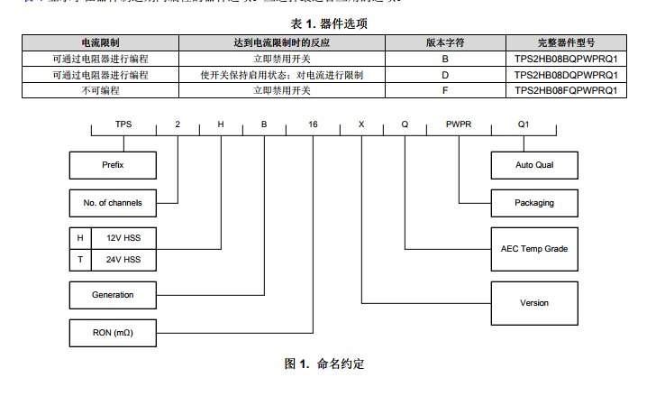

Dear TI:
TI High Switch products can be used in 24V system , such as bus or truck .
or does ver "T" products released or not.
thanks.
Dear TI:
thanks.
Hello-
As of right now, we do not have any release high side switches that are tolerant to 60V load dump for 24 V automotive systems unfortunately.
Alec
please check the recommended operation conditions for the specific device. The following parts can support 24V system:
- TPS1H100-Q1
- TPS1H200-Q1
- TPSxH160-Q1
- TPSxH000-Q1
The T version is not released
