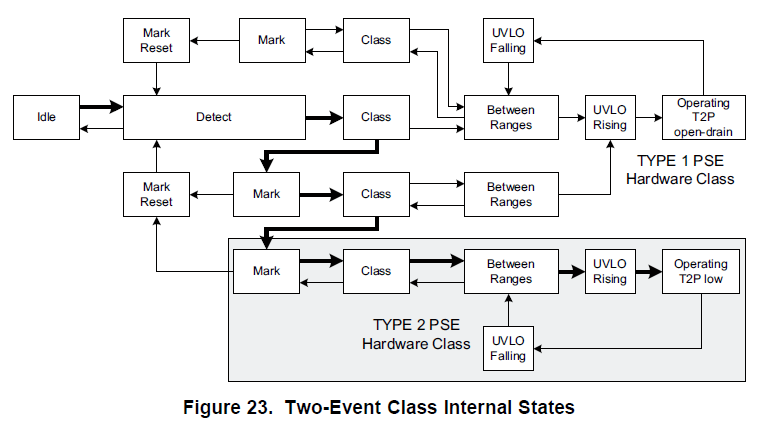

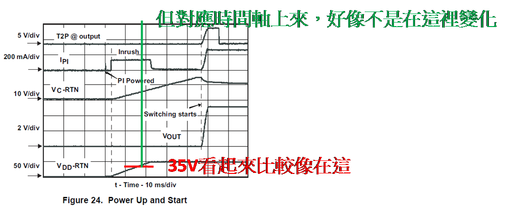

TPS23754: TPS23754 how to set Rcs value? What's the function(meaning) of Class, Mark, Mark reset ? Whitch part is the Vdd>35V (fig. 24)?

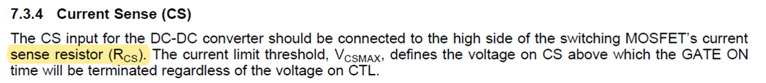

1. How to set Rcs value?

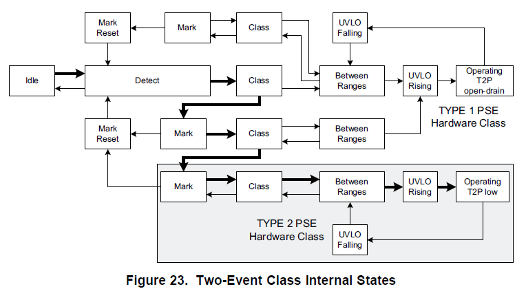

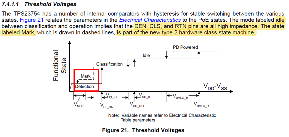

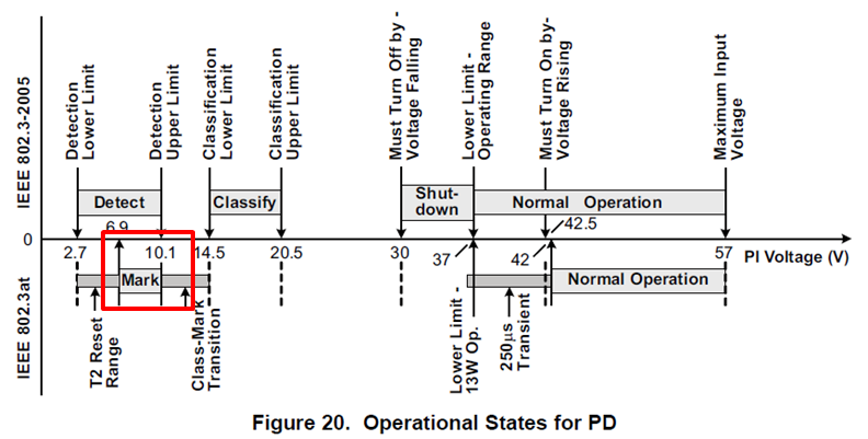

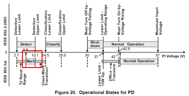

2. What's the function(meaning) of Class, Mark, Mark reset ?

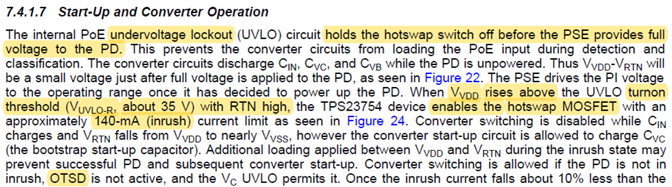

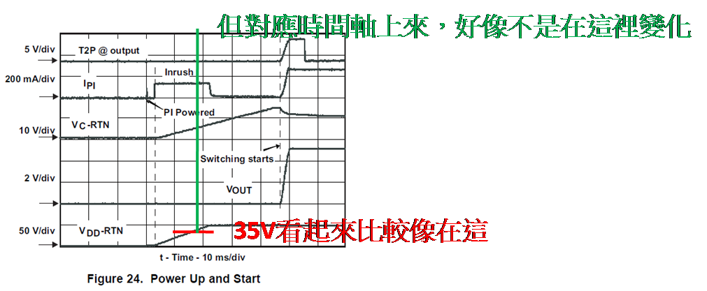

3, Which part is the Vdd>35V? It looks like at red line. However, it didn't change at green line.
Thank you
  • Hi Tienhua,
    1. Use Vcs(max) = I^2*R to determine the size of resistor to use so that the a desired peak primary current meets the Vcs(max) threshold. See the calculations in section 2.5 to 2.7 of slva305c for more details.
  • 2. What's the function(meaning) of Class, Mark, Mark reset ?
    More details about all three are found in section 7.4.1.4
    VDD-VSS=35V is UVLO. See figure 22.
