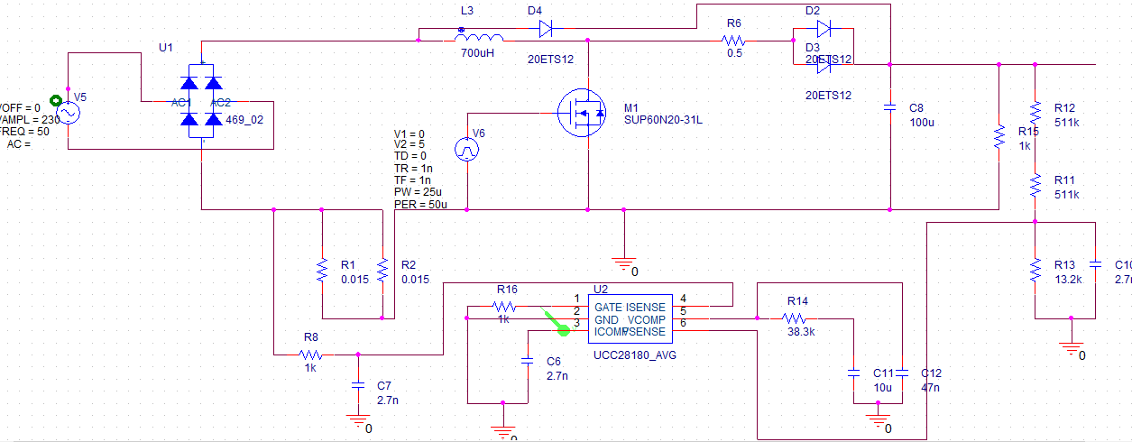

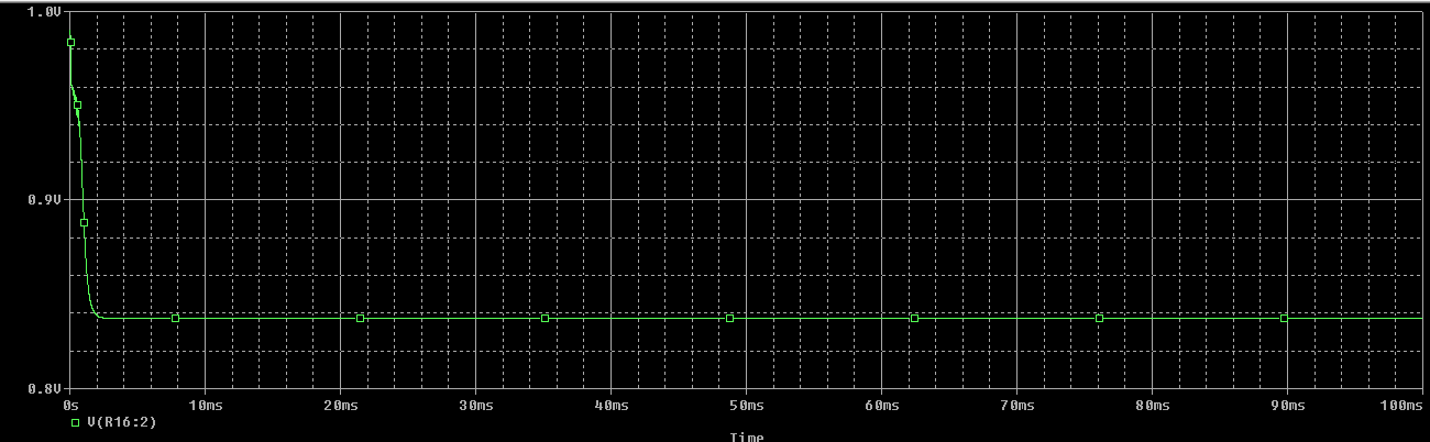

Please find PSpice model attached. I am trying to simulate the converter in open loop, with 20kHz frequency to see how the gate signal looks like. I have attached the probed voltage at gate. Please help me understand what may have gone wrong. I have used transient model of UCC28180 obtained from TI.
