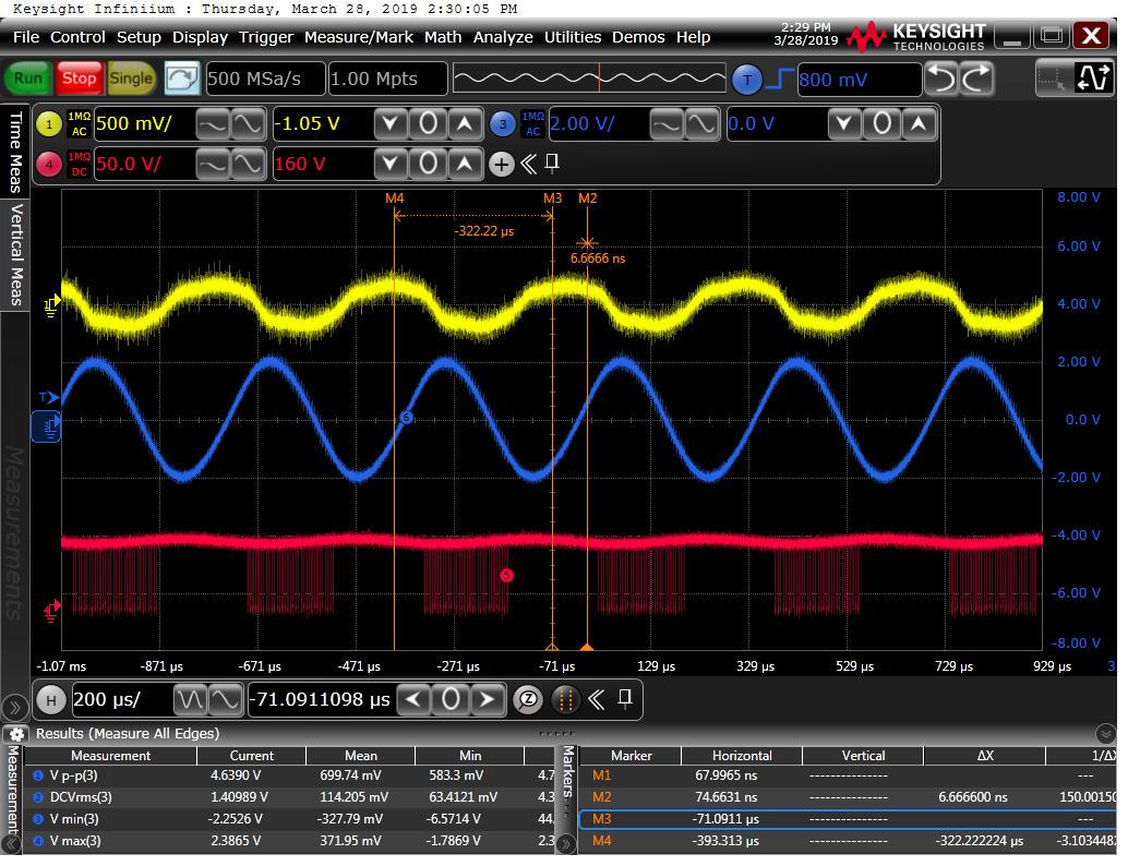

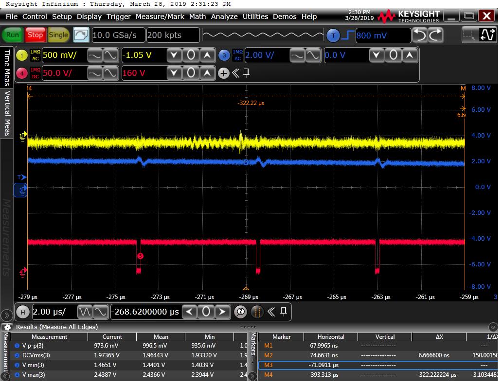

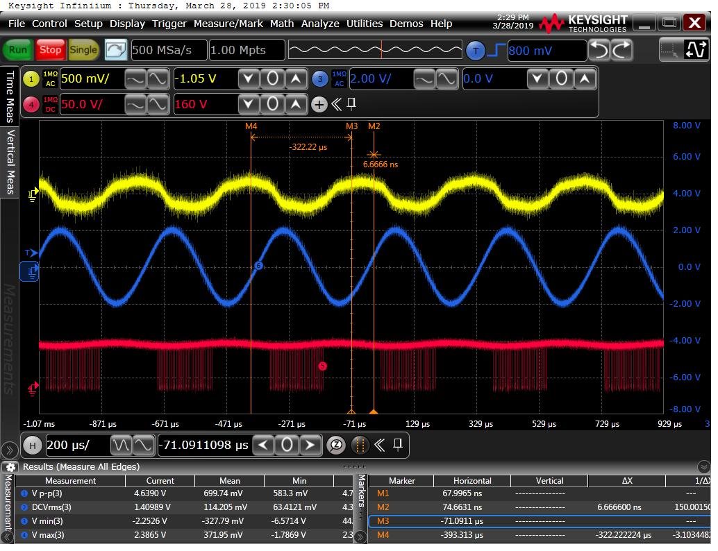

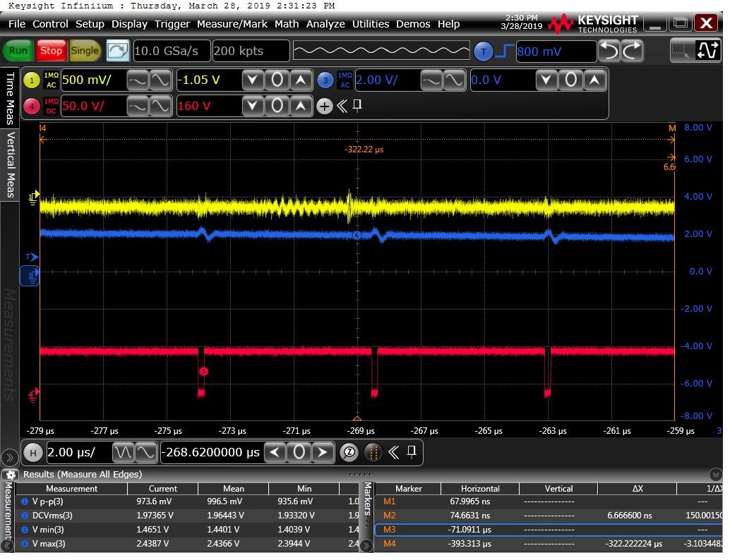

Hi team,
My customer is using the LM5022 now.  The input is 40v~57V, the output is 54.5v, When input voltage is 53.5~55.5v, with 0.4A load current, the output will have large voltage ripple. We know it's because the diode and the loop. But the voltage ripple is too large. Do we have some methods to improve it? Thanks.
(yellow is the input, blue is the output, red is the VDS)
