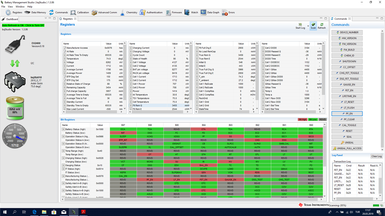

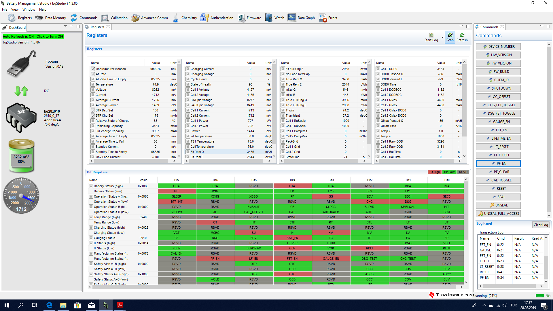

Overtemperature condition does not trip the related FET in both charge & discharge.
Both firmware versions(1.7 and 2.0) were tried  with no success.
Data flash values:
OTC threshold  55 degrees,  delay 2s, recovery threshold 50 degrees for charge
OTD threshold 60 degrees, delay 2s, recovery threshold 55 degrees for discharge.
Enabled protections D OTD and OTC are set.
Any help appreciated.
