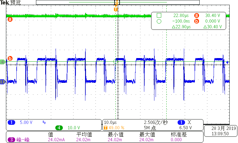

The issue phenomenon:

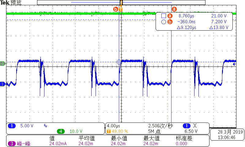

  1. They connect a 470Kohm resistor in RT pin to set the switching frequency to 122Khz but the actual switching frequency only the 1/2 of calculation. Are the formula in data sheet is correct or wrong?
  2. I wondering to know the gain of the current sensing resistor amplifier. Datasheet didn't give this parameter.
  3. The switching frequency becomes unstable when in higher load (2A). And the gate drive signal is also abnormal.
  4. What waveform we should seeing in RT pin when its normal? (If you can capture a picture is the best)
  5. Do our boot cap have UVLO protection? What's the threshold and machanism?
The and abnormal wavefrom is shown below:

    The datasheet is correct, and your circuit also operates at 122kHz. You seemed being misled by the waveforms. They actually two pulses together, one small and one big.
    Obviously your circuit does not have adequate slope compensation. A quick way to resolve this is to increase your inductor, or reduce the current sense resistor.

    The waveform you have seem is capture after I replace the RT to 240Kohm which will set switching frequency to 244Hz in calculation.

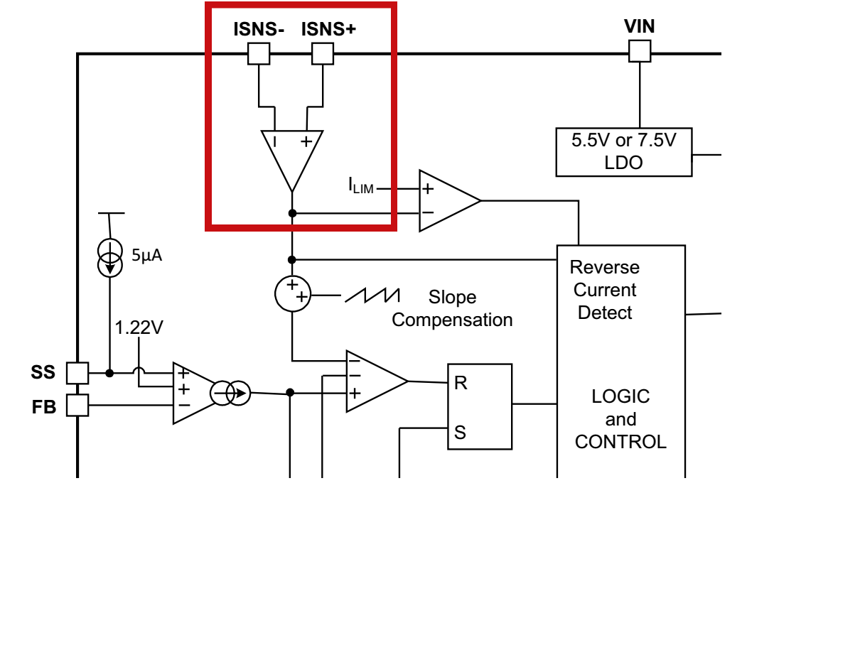

    1. What's the gain for the current sensing amplifier? (Have shown in below diagram)
    2. If customer can't comply with the PCB layout guideline as PCB size limit reason. And can't place sensing resistor nearby the IC. How to optimize the current sensing filter to improve performance?

    1. The CS gain is 10, which is specified in the datasheet EC table, and also clearly shown in the block diagram on page 14 of the datasheet.
    2. You still need to follow the layout guideline instruction in the datasheet. The key is to get a clean sense signal from the resistor. So, kelvin sensing with two traces closely side by side is very important.
