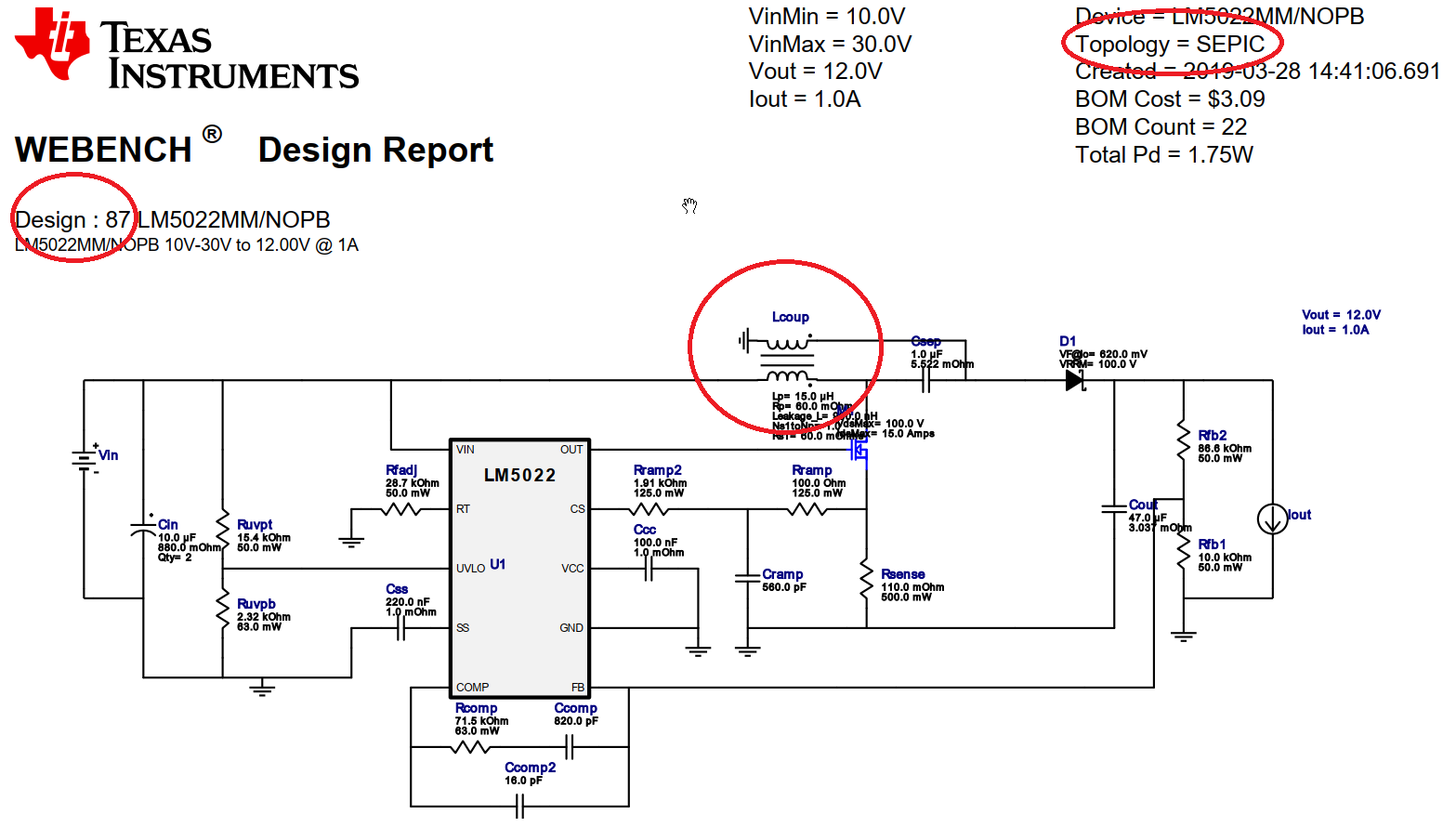

I'd like to create DC-DC converter in SEPIC topology with adjustable output voltage that can be controlled by MCU powered by 3V3 (with digital rheostat or DAC) .
Requirements:
- input voltage: 10-30
- nominal input voltage: 20 (in most cases this voltage will be as input)
- output voltage: adjustable in range 3-24 (with digital rheostat or DAC)
- nominal output voltage: 12V (in most cases this voltage will be used on output)
- output power: 12W
- voltage logic of MCU used to control output voltage = 3V3
I've already built and tested SEPIC converter based on LM5022 (webench.ti.com/.../webench5.cgi
SEPIC_None&topology=SEPIC&optFactor=3&VinMin=10&VinMax=30&O1I=1&O1V=12&op_TA=30&application=
SWITCHER&origin=ti_panel) and I'm wonder if it is possible to simply modify it to meet above requirements.

    Thanks for answer. I have no idea why previous link is not working, I hope that this one will work for you: webench.ti.com/.../87
    I have requirement to deliver 12W on output so for 12V there should be 1A but for 3V current should be 4A. Do you think that it is sufficient just to add DAC with resistor between Rfb resistors and output power will be more or less the same for different output voltage?
    Could you please help me with Rfb resistors calculation and DAC selecting with assumption that 12V on output is default value (and should be set after DAC reset)?
    Many thanks in advance for your help.
    Tadeusz

  • Hi Tadeuz,
    Sepic requires two inductors, either couple or uncoupled. Boost requires a single inductor.
    If you look carefully, the pmp7305 uses coupled inductors, and your webench circuit uses single inductor. The are completely two different circuit.
    In your application, you need a sepic. Please refer to a power electronics textbook for detailed descriptions. You should start your design with the max current, then when you raise voltage the working current can be smaller and your inductor selection should be okay.
    Youhao
  • Hello Youhao,
    I have no idea why you can see only single inductor on my design number 87. Please have a look at the attached picture of this design. I can see coupled inductors there and WEBENCH also reports this design as sepic:
    Nevertheless, many thanks for equations and all clarifications.
    Tadeusz

  • HI Tadeusz,
    I just came back from a business trip. Sorry for the delay. Somehow I did see a different circuit last time, but the link is no longer accessible.
    The circuit that you showed looks fine. Just make sure that your inductor can support 4A load when you adjust the output to 3V.
    Youhao
