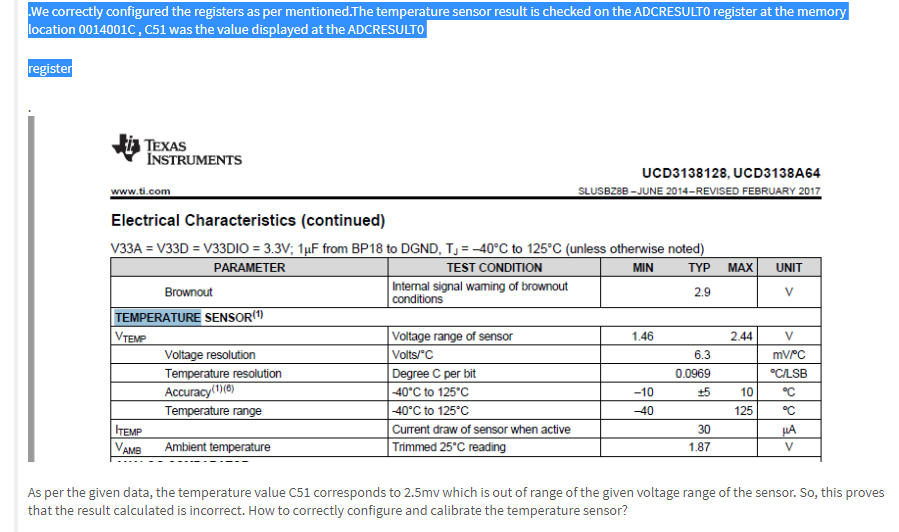

CCS/UCD3138A64: Calibration and configuration of temperature sensor in ucd3138A64
Part Number: UCD3138A64
  • an expert is looking at this, will get back to you soon.
  • Hello Shoeb,
    The ADC count from the result register need to be deducted from the value in the TEMPREF register then multiplied by the "Temperature resolution" from the table above, and that will provide the temperature elevation above room temperature (25 C).
    For example, let's assume the register TEMPREF is showing the value of 3030 decimal.
    Your result register value of C51 hex translates to 3153 decimal,
    Therefore the temperature is  ((3153 - 3030) * 0.0969) + 25 = 11.92 + 25 = 36.9 degrees C
