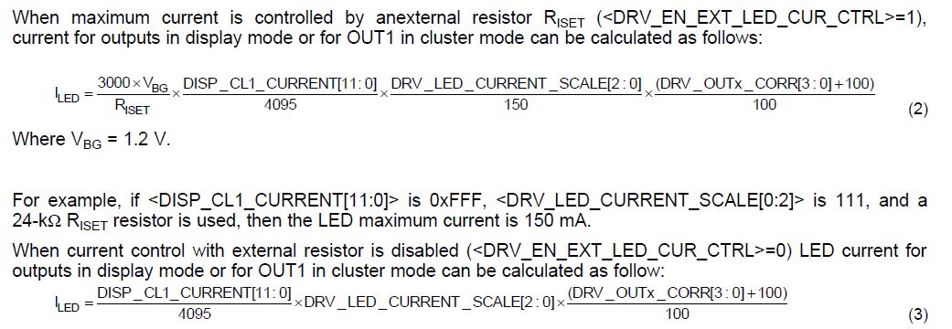

1. About LED current,  their are two ways to limit the current ,
  ① . set register 0x66, EN_EXT_LED_CUR_CTRL to 1,LED current is scaled by the RISET resistor
 ② set register 0x63, DRV_LED_CURRENT_SCALE[2:0]
 My question is, if above two ways are all set, which one will the  LED current follow?
2. LED_STRING_CONF[2:0] is to set LED current sink configuration, will the phase shift influence the total current?
