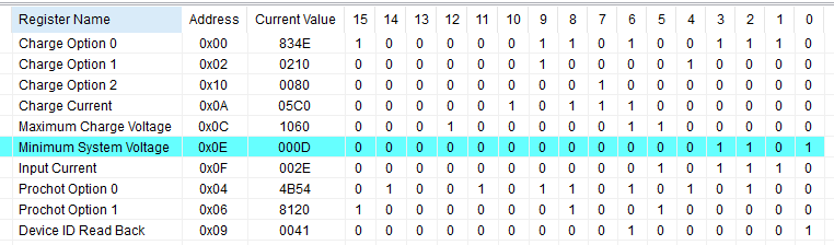

  • Hello Angelo, thanks for the info about the power supply.
    I tried disabling the ILIM pin and using a different power supply, both of them did not work. I also tested with a different battery sample, but still the same results. I'll try connecting the capacitor and/or load tomorrow and let you know the results. In the meanwhile, here's a snapshot of the register settings for my current configuration. I've disabled the watchdog timer:

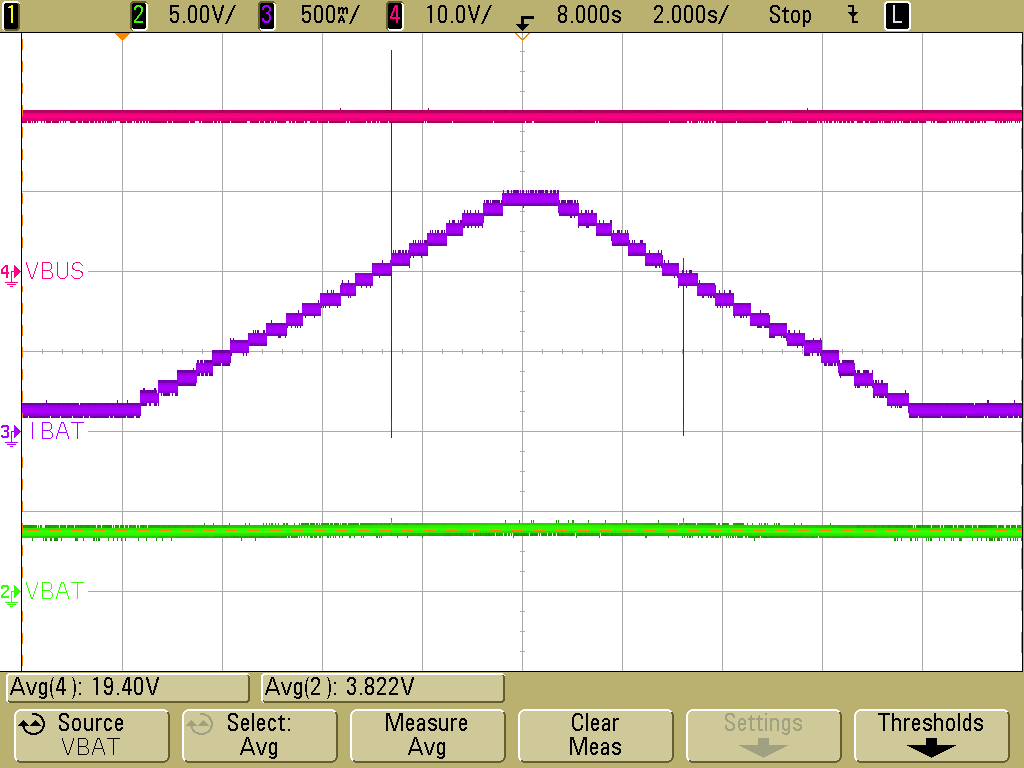

  • Hi Ved,
    I just tried on an EVM with your register settings, VBUS = 19.5 V, VBAT = 3.8 V, and SYS floating, just like with your test setup (except with a 2200 µF capacitor instead of a real battery). I was able to increase ICHG above 700 mA, as shown in the waveform below, where I increased the ICHG register setting from 128 mA up to 1472 mA, then back down to 128 mA.
    There's also another possibility that we haven't discussed yet. What are the states of the four switches on S1? If they aren't already, please have switches 1 and 2 open (in the down position) and switches 3 and 4 closed (in the up position), as described in the EVM User's Guide. I was able to suspend charging by playing around with those four switches, so they might be related to your issue.
