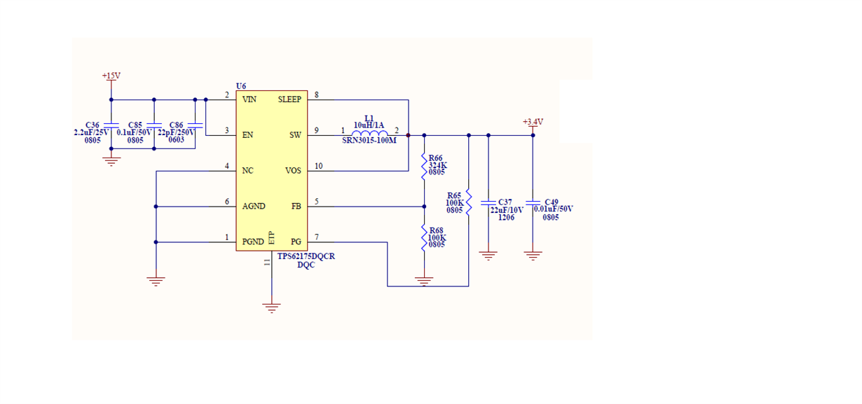

=> We are facing startup issues with TPS62175 design. It worked well till now with 0.25A resistive load.

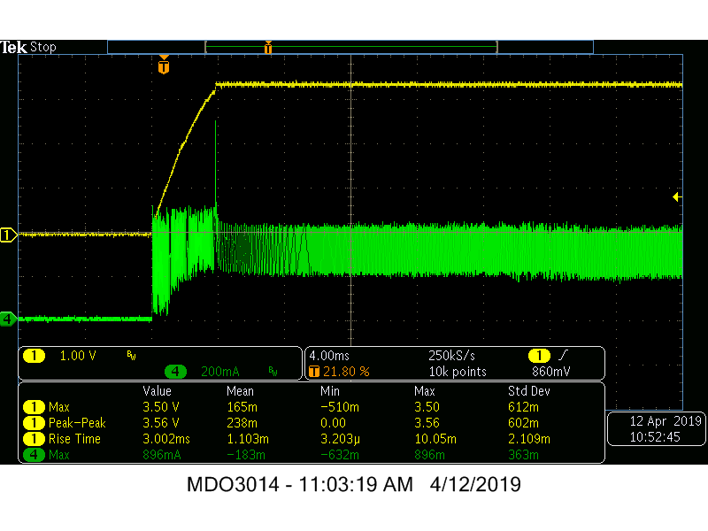

=> But as same design could be used upto 0.5A, I tried using it for 360mA load & found Vout is stuck at 2.52V (waveform attached) which never returns to 3.4V. However, if I removed load in powered condition & then reconnect in powered condition then no issues. That is TPS62175 is able to sustain 0.35A load in powered condition but not during startup.
=> It seems IC enters current limit mode but is unable to recover from that.
=> Attached are also the waveforms with 0.3A load where IC seems going in current limit mode but recovers after some ms & returns to 3.4V. However, here IC goes upto 3.16V
=> Design parameters are VIN=12V to 18V, VOUT=3.4V at 0.25A.
=> Inductor used SRN3015-100M having Irms=1A, Isat=0.88A which I think is similar to ones as recommended in datasheet.

    You are likely triggering the reduced current limit during startup, as explained in section 8.4.1 of the D/S. You could measure the inductor current to confirm this.

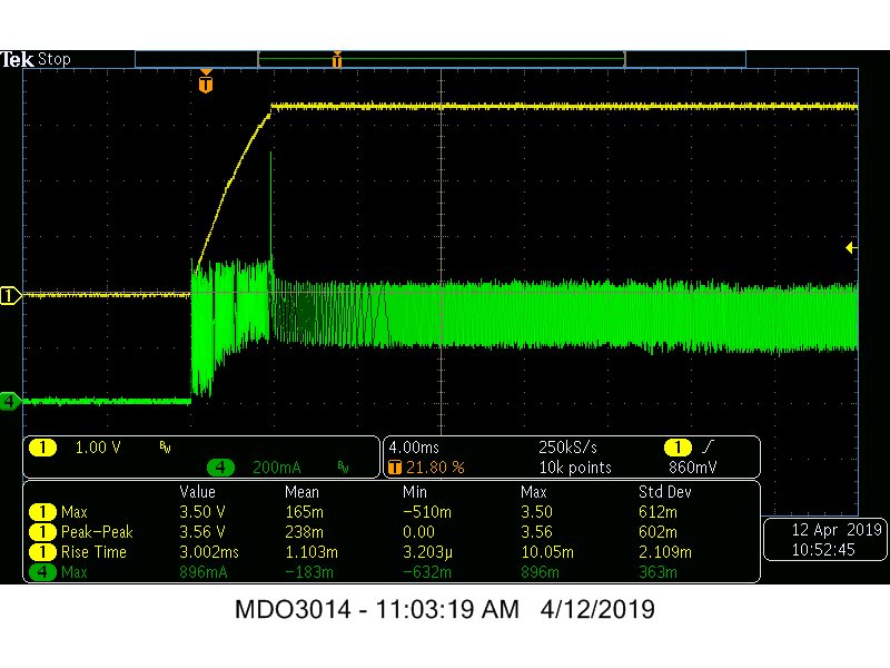

    Sorry for replying late as I was out of office. Please see attached waveforms with 7.9E & 13.5E. The difference is there is some current glitch with 13.5E when output voltage reaches 3.4V which is absent in case of 7.9E. These waveforms are similar to ones as shown in datasheet.
    => So if you think IC is going into startup current limit then I don't understand the reason of marketing this IC as 500mA regulator. I think any IC is required to bear the startup of max load for which it is defined.
    => What is the solution to this issue, kindly advice.

    1. Please find attached schematic section of 3.4V section.
    2. Also we are using resistive load during startup.

  • Hi Jagdish,
    Chris is out of office so I will help you answer your question.
    This feature of limiting the inrush input current at start up is made to protect the system integrity.
    What you see as a load at the output is an average value of the current in the coil. So this device can handle peak current up to 1A before it triggers the current limit when the system is in steady state.
    I would recommend you make sure the system is in steady state before applying the load so the current limit will be shifted to a typical 525mA peak to a typical 1A peak. It would then be considering a different power up sequence in your system to have a smoother load start up so the system can start up properly.

    The TPS62175 does not have a Soft Start pin which would allow your system to start up the way you want. I think we need to find another device for your system that has the internal soft start circuitry.
