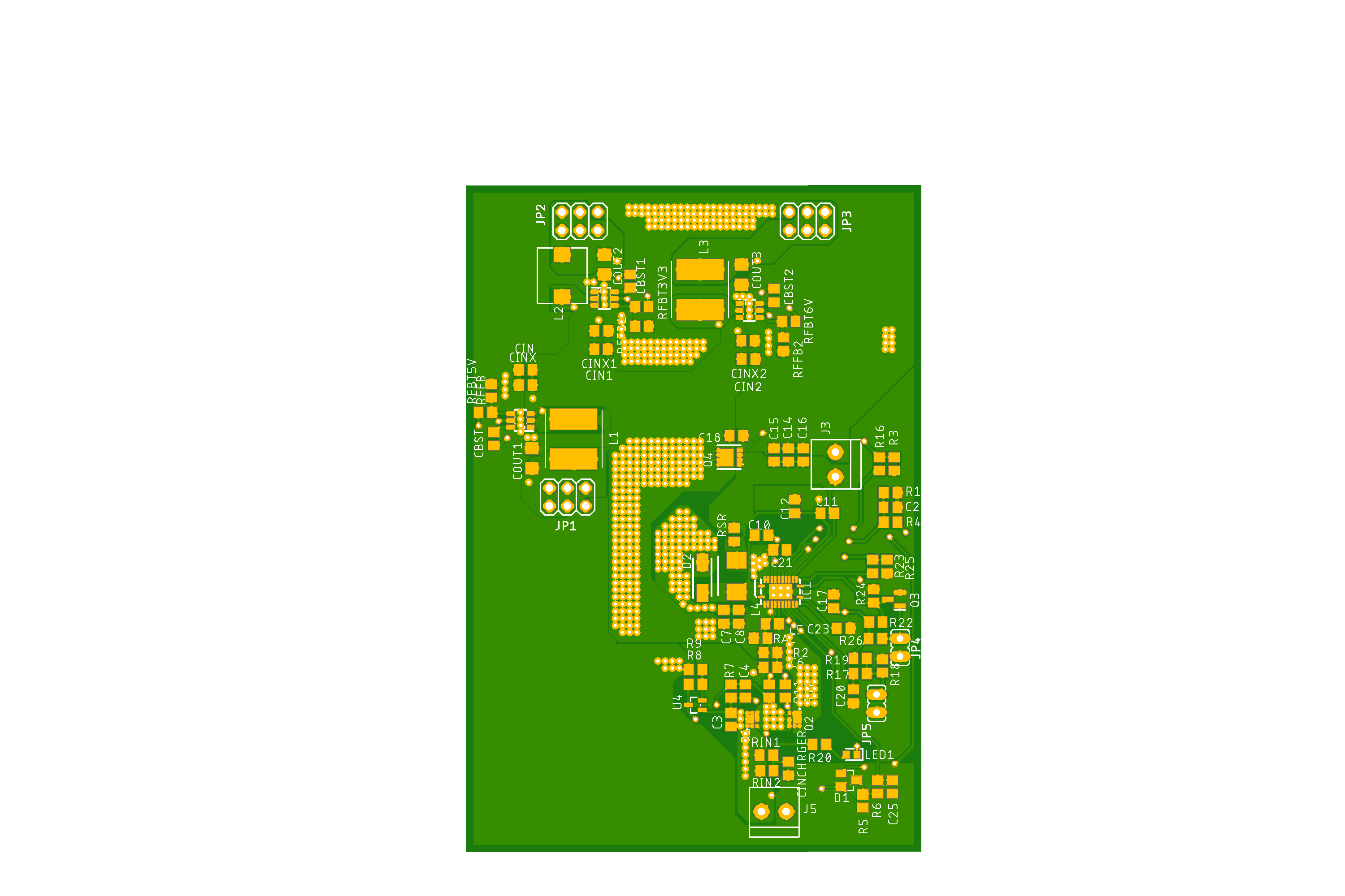

First of all I want to clarify that this is my first experience in the realization of PCBs.
I am a computer engineer.
I have the idea to make a robot. For that I decided to separate my circuit board in two. One for logic and the other for energy management.
This is the second pcb that I have problems.
It serves as a charger for my batteries 3s, converter dc-dc ( tps5652) 6V, 5V and 3V3 .
I have the constraint of making a board with two layers but has a reflow oven.
I share my board in eagle format, all remarks and recommendations are welcome.
Thank you very much in advance for your help

  • Hello Julien,
    I have reviewed your schematic. I do not see any obvious errors except for OVPSET having a resistor and capacitor instead of resistor divider. I am assuming that you used the spreadsheet at www.ti.com/.../sluc244 to properly size the components? Regarding your dropbox, I cannot access it without requesting special access through our IT department which can take a while.
    Regarding layout, I recommend following the EVM layout as documented in the user's guide: www.ti.com/.../bq24170evm-610-15v. The key components for any buck converter are the input capacitors to the converter, which will be capacitors on PVCC pins.
    Jeff

    I upload a zip file. My routing is very uncertain.
    I tried to follow the desing of the EVM but can't do 4 layers board

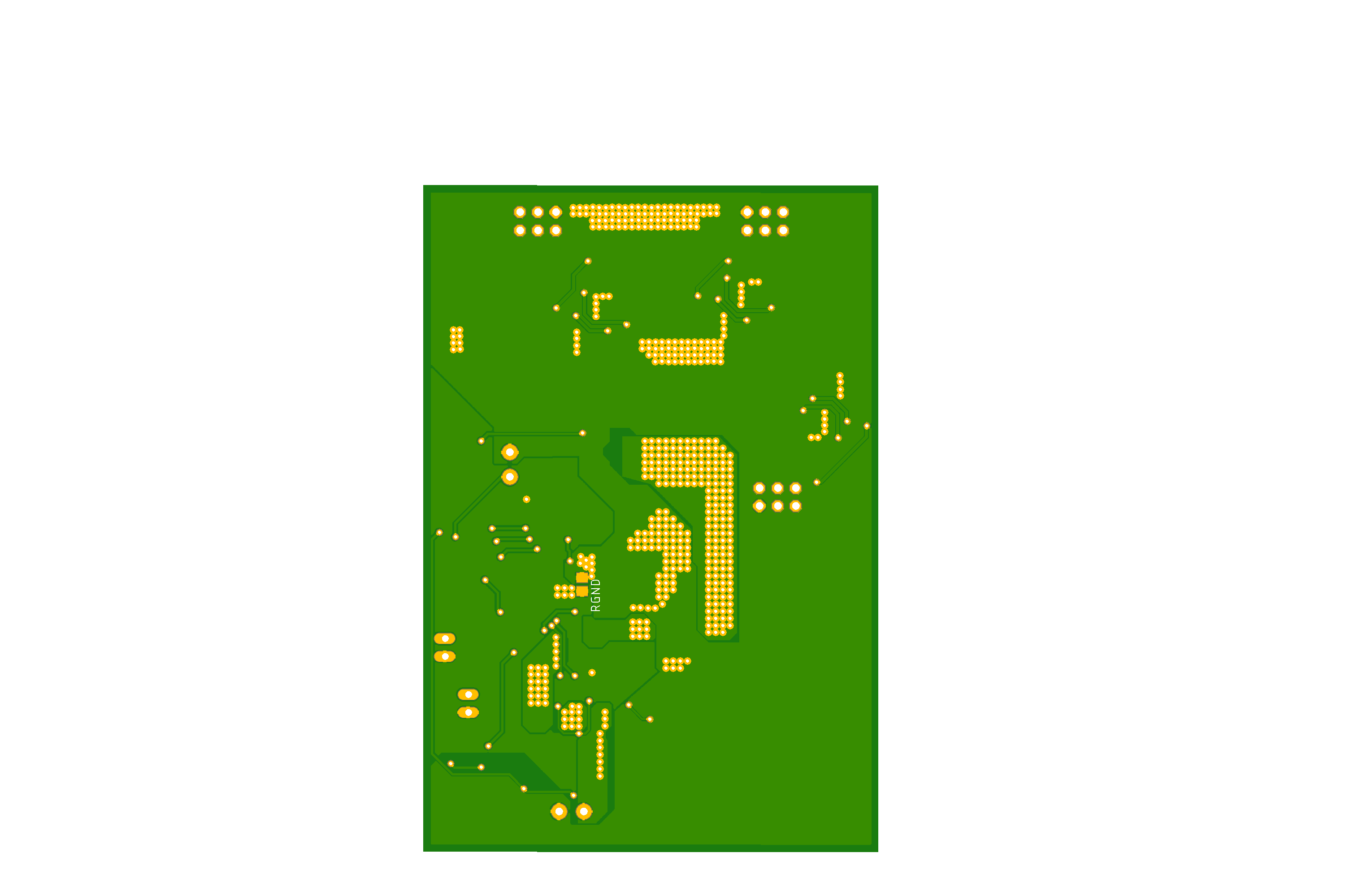

  • Jeff,
    Here is my board
    Thank you again.
  • Julien,
    I do not think your board will burn not be as efficient and have current sensing inaccuracies. At a minimum increase the width of the trace from the inductor to D2 and move C14, C15, C16 on VBAT closer to RSR to reduce high current ripple.
    I think you could more closely follow the EVM if you used one ground plane instead of tying together with a 0 ohm resistor. This also may give more area of the power pad vias to use for heat sinking. Careful placement of the threshold setting resistor grounds and the filter capacitor grounds would be required so that switching currents do not flow through their grounds. For example, you place all of the buck converter components (including C14,C15,C15) with PGND on the end of the IC (and underneath) with pins 1, 2, 3 and 22, 23, 24 and then all other components with AGND on sides and other end (and underneath) like the EVM. You can use the power pad vias for AGND return and tie the power pad to the PGND pins under the IC.
    Jeff
  • Thank you Jeff for your time,
    To be honest, I did not quite understand your second paragraph. could you explain yourself please?
    I followed the other remarks you made to me. The hazardous placement of my components is due to my lack of knowledge in electronics. I want to know more.
    I also removed the components marked "open" in the BOM of the EVM. Is it ok?
    about OVPSET: I followed the schematic of the EVM :
    In my case, R9 should not be present.
    thank you,
    Julien
  • Hi Julien,
    The user guide BOM has a typo. The line under the R9 in column 3 should be removed so that both rows refer to R9. R9 for build -002 is 37.4k. A bottom resistor is required. Same for R2, R10, R22.
    Regarding my comments, if you group all of the buck converter switching components on in one area, attached to a large ground plane and then group the threshold setting and filter components needing a clean analog ground in another area on the same ground plane, the noisy switching ground will not affect analog ground components. The ground currents will choose the lowest impedance path back to IC ground. For a buck conveter, the most important components that need to be closest to the IC are in priority:
    1.the REGN capacitor
    2.the BTST capacitor
    3a.the power input capacitors that connect to PVCC- for lowest EMI
    3b. the Schottky diode on switch - for higher efficiency
    4. the output capacitors
    5. the inductor (caveat - use multiple vias to connect to the inductor but the larger/longer the trace, the greater risk for EMI).
    Jeff

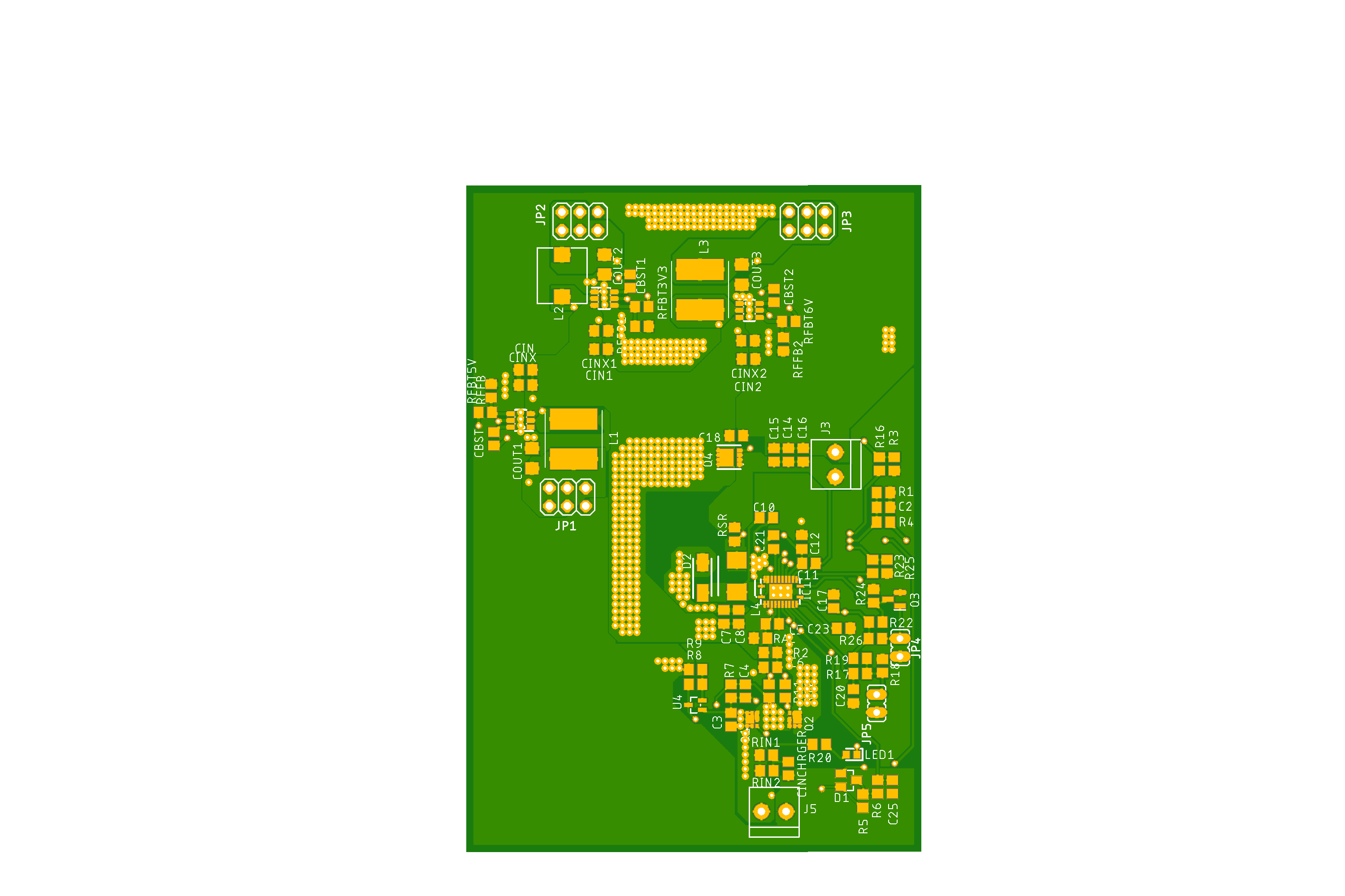

  • jeff,
    Thank you for your patience.
    I made many changes as a result of your remarks.
    Indeed I read the BOM badly. I corrected the problem, I believe.
    Here is my new diagram, and my new PCB. Can you tell me what you think about the new version?
    I have not touched the buck part so far. And I have not merged the two ground plans yet. I mainly rearranged the tuning components and moved them away.
    I wait for your advice to be able to optimize the buck part and finalize by the masses. It's OK ?
    1374.2019-03-16_12-09-44.pdf

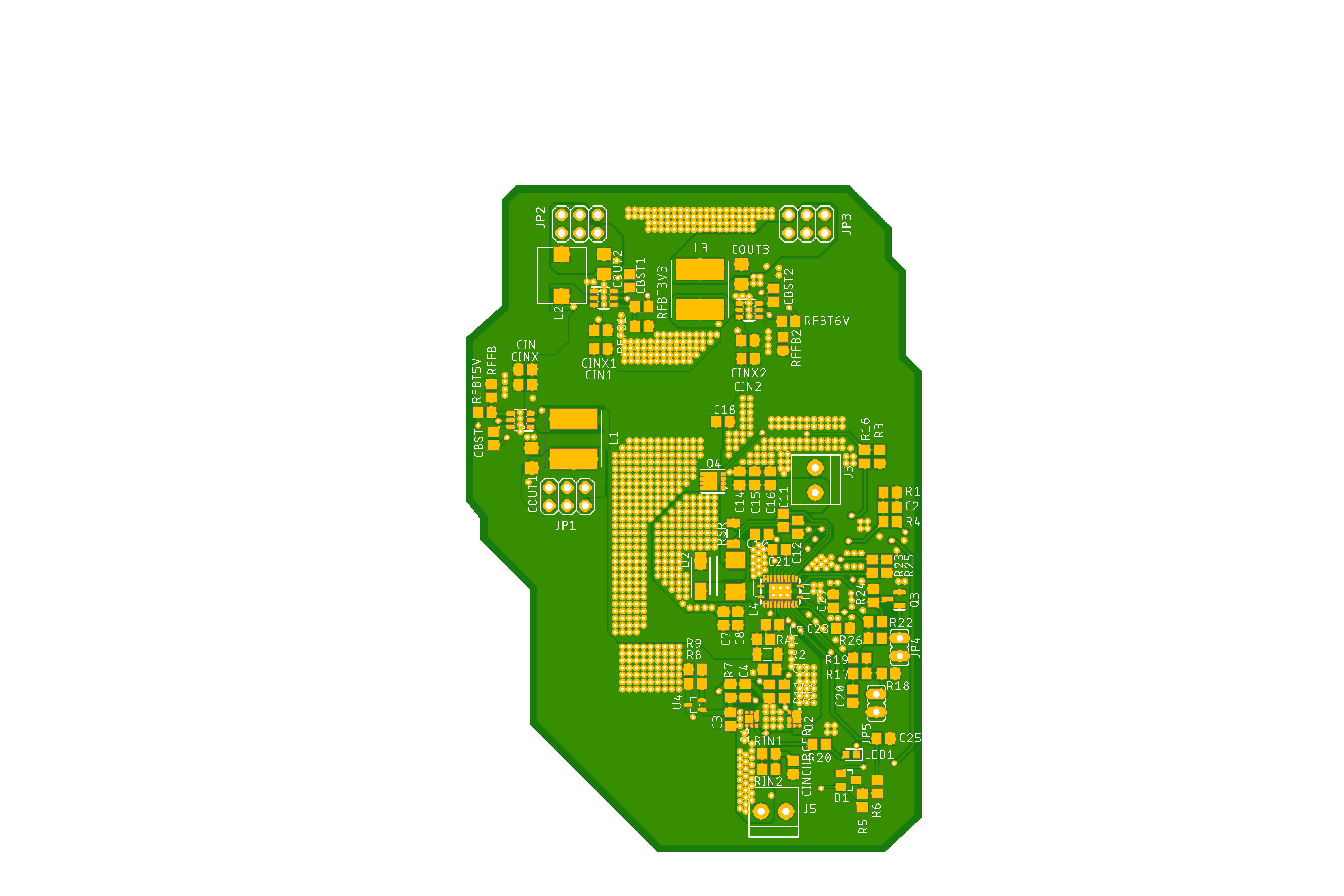

  • Jeff
    This is my last design. It remains 3 airwires that are unrelated ground between them 3. I would like to know your opinion.
    Thank you for everything,
    Julian
  • Hi Julien,
    I prefer an easier ground return to PGND1 for C14, C15, and C16. Can you move them closer and/or add more vias to GND? If you do remove RGND and have one ground plane, please be careful of C14-16 placement as there switching ground currents could interfere with the AGND components.
    Jeff
  • Hi Jeff,
    As you recommended, I think I have shortened and optimized the path to PGND1 for C14, C15, and C1. As well as grouped the two mass plans. I also tried to follow the maximum design guideline , for example as for RSR. I also join my Bom. Can you tell me if you see any abortions?
    thank you,
    I would never have done it without you.
    Julien

  • Julien,
    I don't see any obvious errors with the components in the BOM. I suggest that the buck converter's ceramic capacitors voltage ratings be at least 1.5X higher than the expected DC voltage on those capacitors in order to account for DC bias effects.
    Jeff
