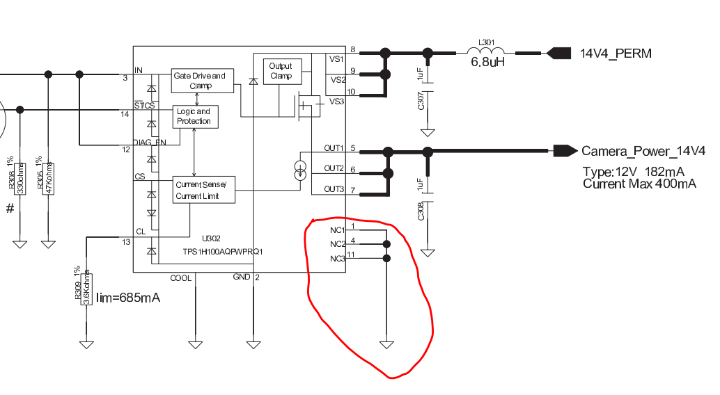

TPS1H100-Q1: Whether the NC Pin pin can be connected to GND
Part Number: TPS1H100-Q1
Hello team,
One customer connected the NC and GND when using the TPS1H100-Q1, and the schematic cannot be changed now because of the mass production project.
So, is the internal connection of the NC pin of the TPS1H100-Q1 connected? Is there any risk in connecting directly to GND?
