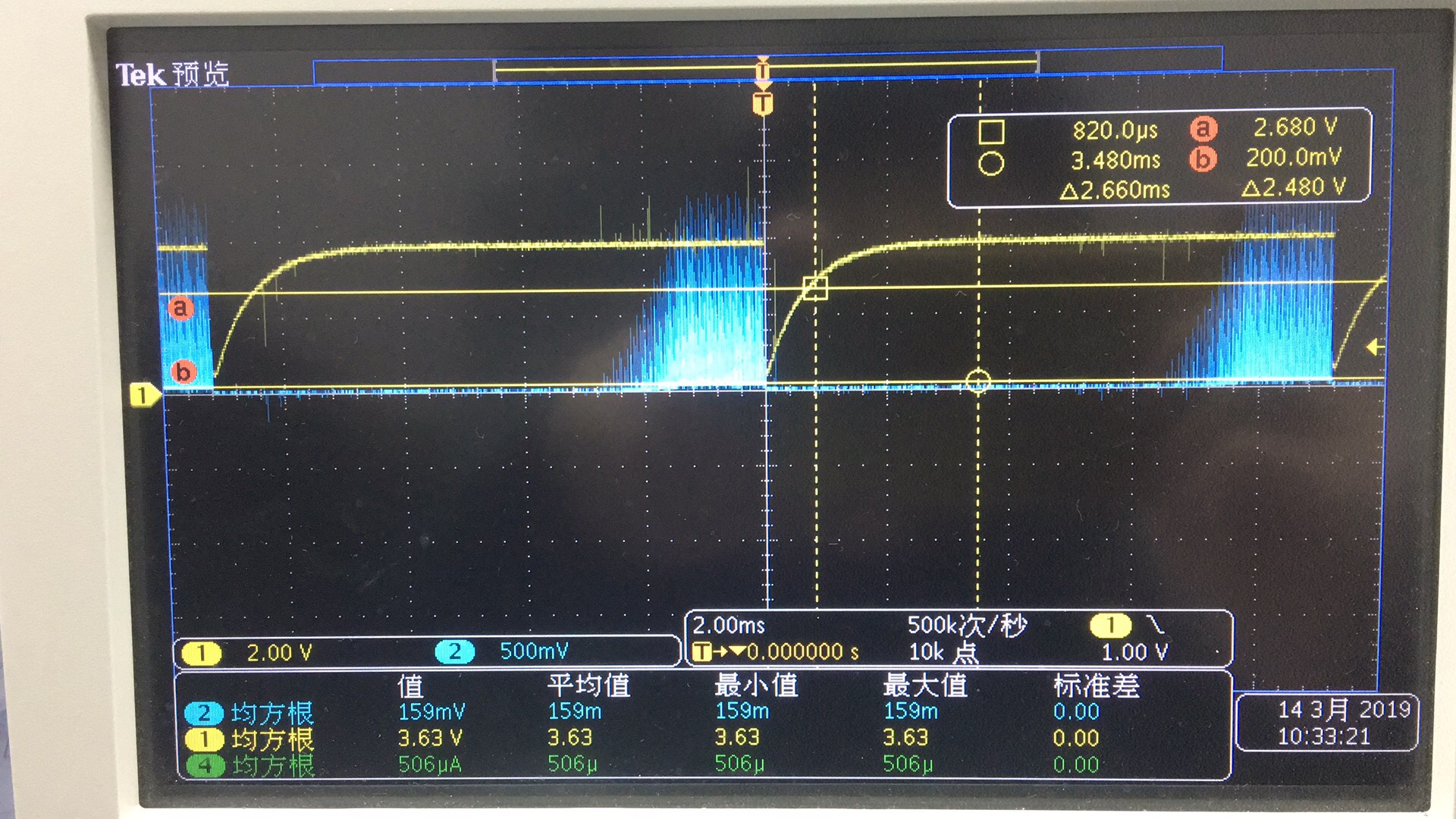

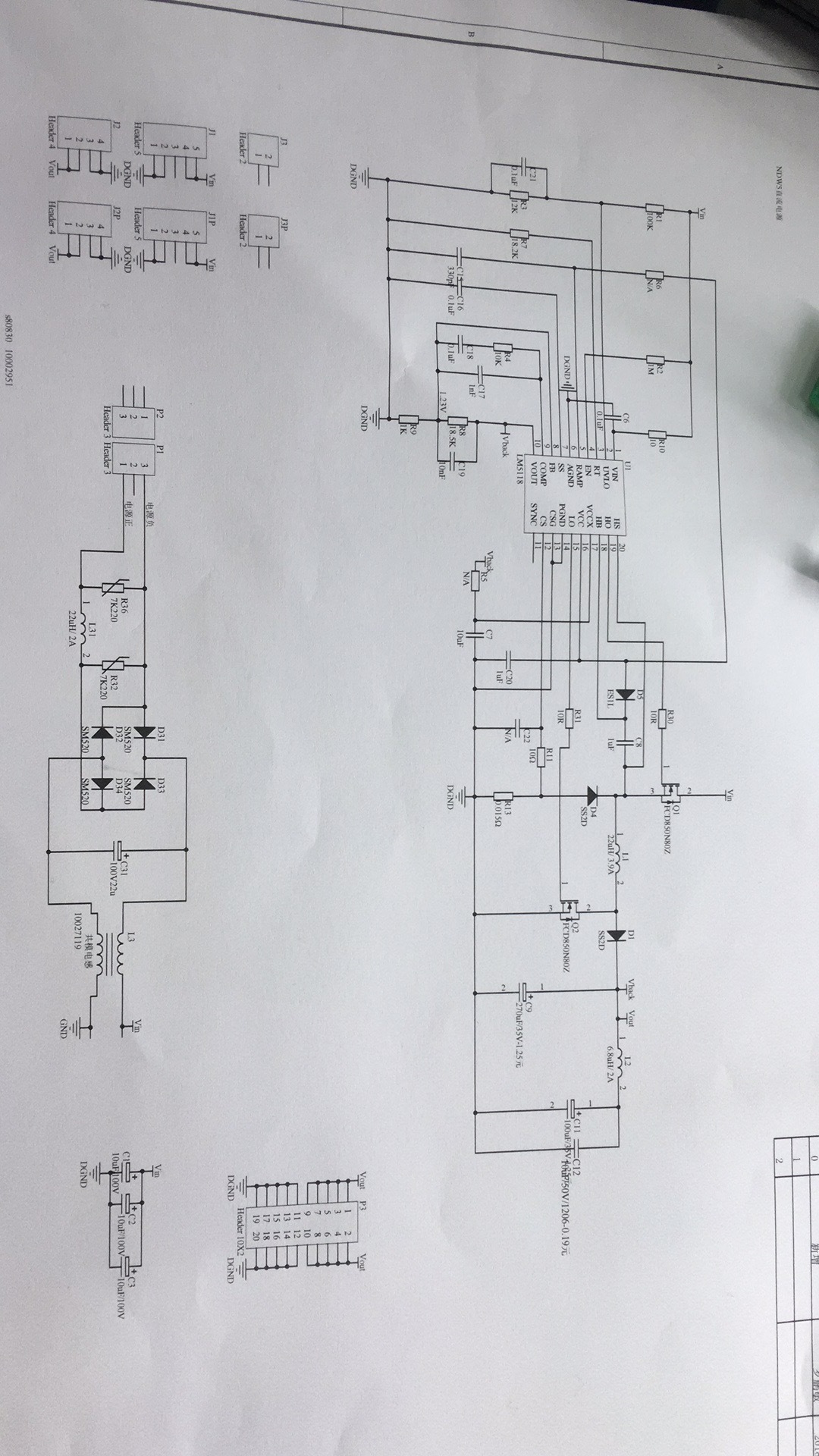

Lm5118 This material application conditions: input 18 ~ 66V, output 24V 700 mA, in Buck mode, the voltage of the UVLO foot is cyclically lowered, the waveform looks like an overcurrent 256 cycle point. In addition, in the case of loading, it can not start. The schematic diagram and the waveform of UVLO are as follows.
