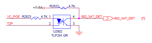

Some of our products use TPS23754 T2P to make PSE af and at judgment. The circuit is as follows.

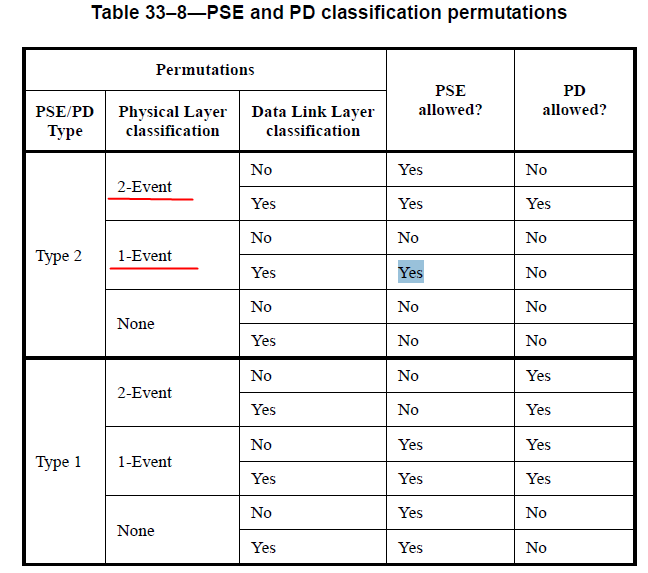

How does TPS23754 T2P achieve af and at depends on one event and two events? Rather than what we understand is that power levels are used to
determine.

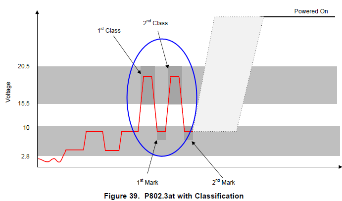

af: one event, maximum power 13W,
at: two event, maximum power 25.5W,
The problem is that the query power level of PSE is Class 4 (802.3at), but the output of T2P is high, which is equivalent to my judgment circuit to determine that it is AF (not in line with the actual situation).

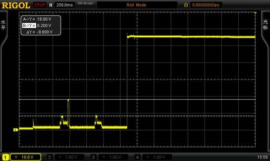

The PSE used in conjunction with TPS2388R chip, the output is one event mode (waveform as follows)

    The TPS23754 can process hardware classification through the T2P pin. However, if the PSE does NOT do hardware classification and instead does data layer classification, then the PSE will limit the power to 13W until higher power is negotiated through the data lines. Below thread goes into this in detail.
    e2e.ti.com/.../2626171 layer#2626171
    Typically, you can configure a switch to do either one. Can you check if it is possible to configure the Cisco switches to do hardware classification?
