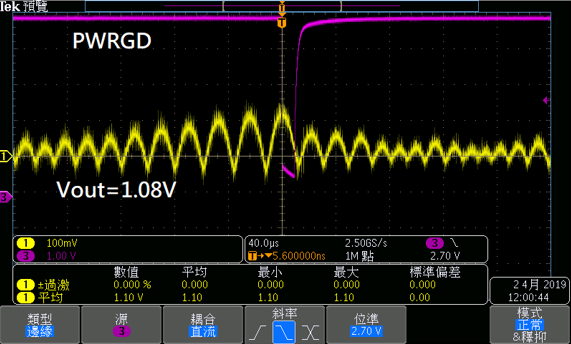

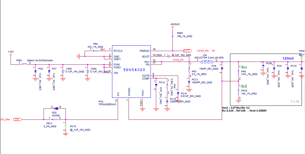

Vin=12V,Vout=1.05,Iout=2A,Iout max=3A,now PWRGD reset often,ripple is large,such as the picture,can you give me some advise about the design?
Zhang,
The loop has very low phase margin. That is your issue. Try:
PC8 = 470 pF
PC15 = 22 nF
PC12 = 47 pF
PR9 = 1.5 k
Let me know if this works for you.
