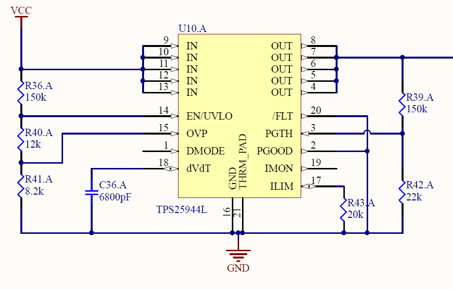

TPS25942L: Latched after power on reset
Part Number: TPS25942L
I have a circuit that uses the TPS25942L as a circuit breaker with latch and my idea was in case of overcurrent, a power on reset was needed. However, I find that in case it latches unplugging the source is not enough, I need to force the EN pin to GND while the board is plugged. What is the supposed behaviour of the eFuse? According to https://e2e.ti.com/support/power-management/f/196/t/662869?tisearch=e2e-sitesearch&keymatch=tps25944, what I did should suffice.
