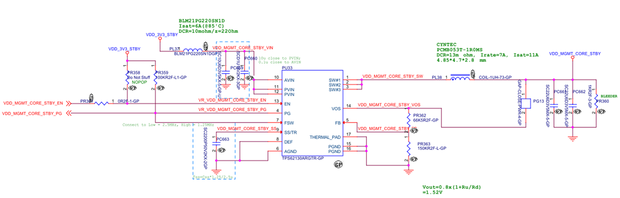

TPS62130A: TPS62130 OCP behavior issue
Part Number: TPS62130A

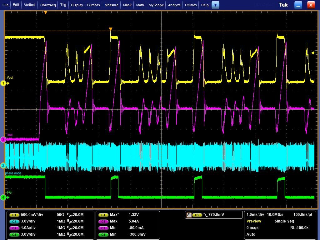

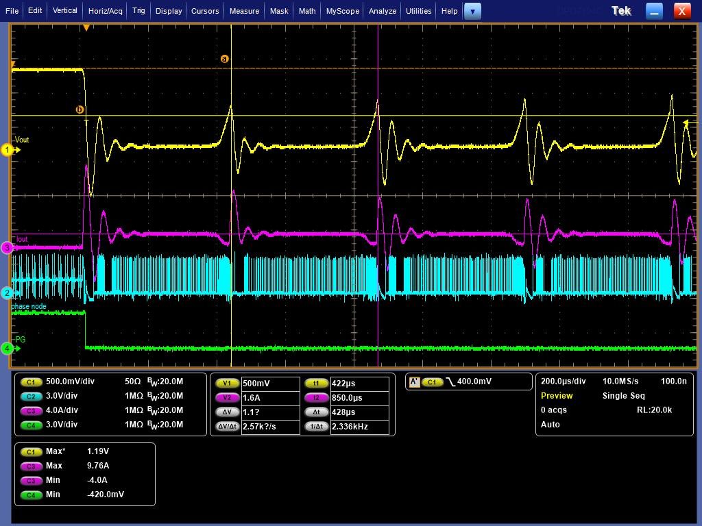

Two waveform is at same test condition, except different DC Electronic Load mode.
The difference of Picture 1 and Picture 2 is that picture 1 is tested by CR mode and picture 2 is tested by CC mode.
Could you kindly help to check the behavior is correct or not?
And why waveform 2 is so abnormal.
