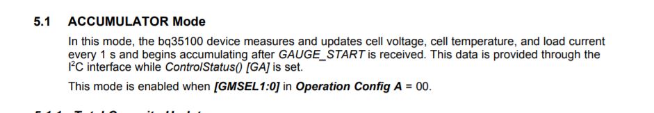

  • Onyx,
    We understand the device needs to be placed in accumulator mode. We've already referenced the TRM, and this is what it has to say about it:
    It says the data is provided over I2C, but makes no mention of the protocols needed to retrieve the data. Commands, register locations, anything. This is what we need.
    Also, you didn't address my second question at all. Can you comment on the measuring of the discharge current?
  • For accumulator mode, the current is just measured through SRN and SRP on the sense resistor. If you needed to measure the learning load for EOS mode, the only way is to size the discharge FET and resistor accurately to assume a particular learning load.
