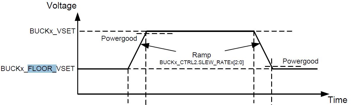

 what is the  BUCK0_FLOOR_VSET ?   How much of voltage should i set it to?
  • Hi, Jesse,
      The "FLOOR_VSET" is a feature to setup the floor voltage level when users using "Enable Roof/Floor control of EN1/2 pin for "Roof/Floor" control.
      As showing by screenshot below:
        By this way, the output voltage level can be changed between "Roof" and Floor" instead of on/off.
