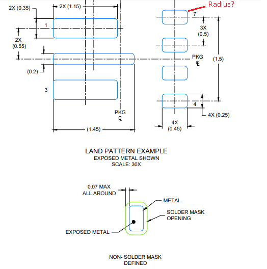

There is no information about the radius value in the step file available on TI TPS61022. Please help with the radius value for the pad of below drawing
