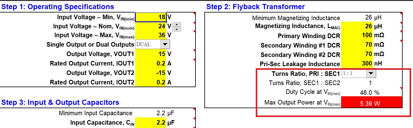

Hi Sir
1. Could you kindly help to provide LM5180EVM - dual's Transformer YA8916-BL SPEC?
2. I would like to know how to design this transformer ,just like Pri-DCR and Sec-DCR
3. Below is Transformer calculator result ,may I know turn ratio 4:1:1 is correct or not ?
Copy of LM5180 PSR Flyback Quickstart Calculator r2.xlsx
