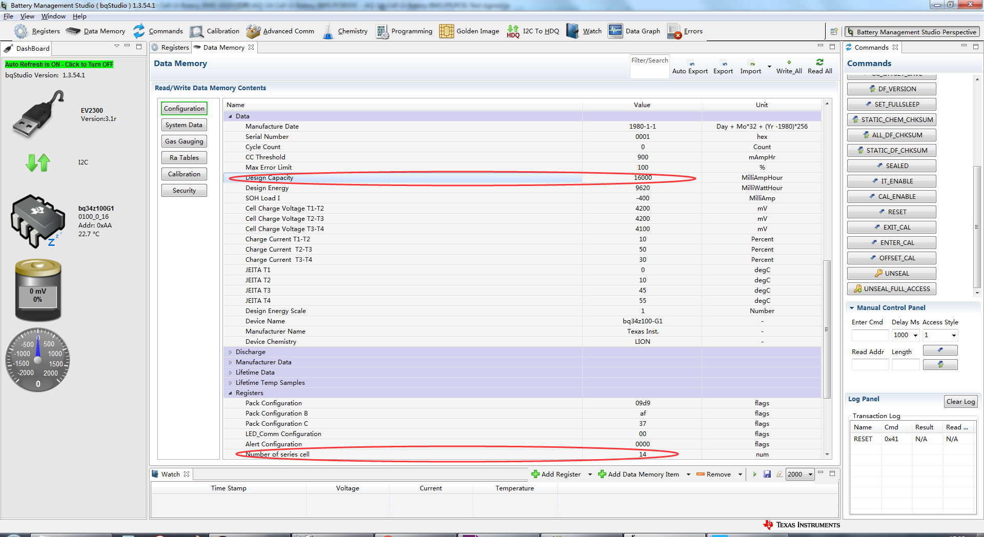

Hello, now I have some problems with learning with BQ34Z100-G1: I just need to get the remaining battery pack, the number of cycles, and the battery health when I use BQ34Z100-G1. At present my battery package single cell voltage is 3.7v, capacity 2.6Mah. a total of 14 series, 6 parallel, design total voltage 48V, design total capacity 16AH, in the battery software set a string number of 14 strings:

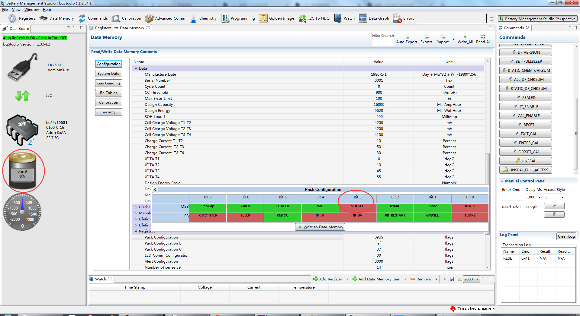

And set the VOL_SEL in the PACK to 1, but my capacity has changed to 0:

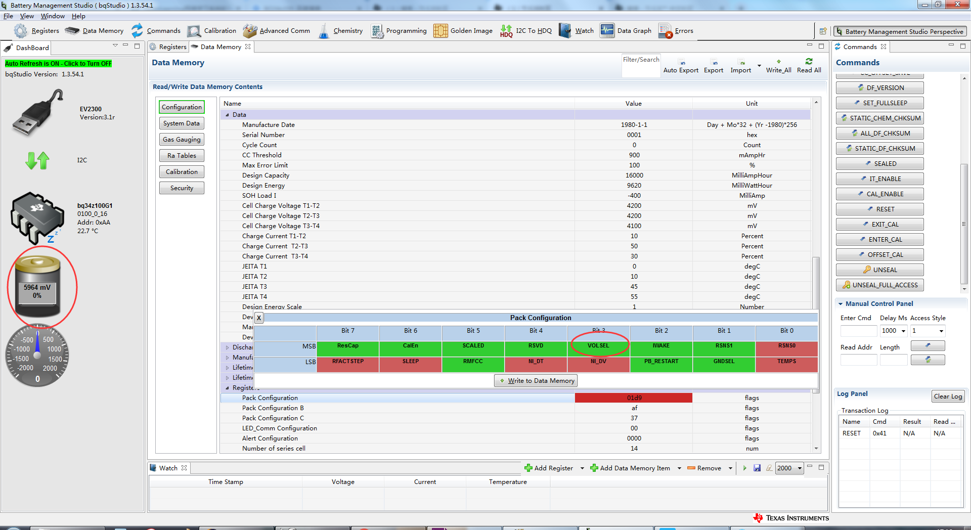

If I turn the VOL_SET of the PACK zero, the display of the capacity will become 5964:
