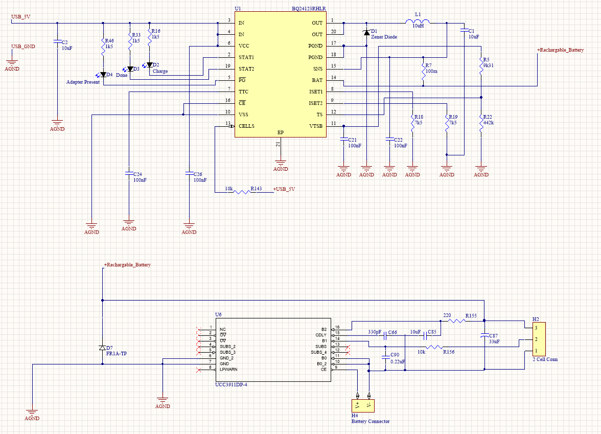

BQ24123: UCC3911 Protection with BQ24123 Charge Control
Part Number: BQ24123
I have made a circuit design for charging 2-serial connected Li-Ion batteries through USB 5V input with overcharge protection. Could you check the design?
