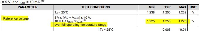

my customer wants to know specs which cannot be found in datasheet. If it's available, please provide?
1. accuracy over the full temperature range (-40∽125 °C):
2. quiescent current:
3. temperature drift:
4. output resistance:

    All of these parameters can be found in the datasheet.
    The output voltage is equal to the internal reference voltage gained by your external resistor divider.  As such, the reference accuracy is your internal accuracy for this regulator.
    Please note that LM317A does not have a GND reference, as such the terms Iq and Ignd are not used.  Instead the current required to power the linear regulator will be Iadj.
