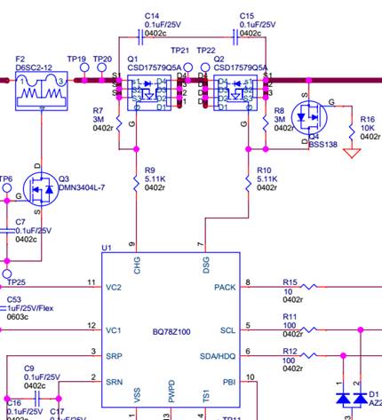

As shown in the picture, R7, R8=3M, Will affect the stability of the circuit work?
And the recommended value of R7, R8 is10M.
I am a little worried about charging and discharging FET off, I can also measure the output voltage if I use 3M resistance.
Because my product has been shipped, I am not sure if there is any other problem.So I'd like to hear some advice from you.
