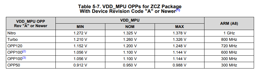

    >Why can't you use STRICT=0b for the AM3358? The STRICT=1b setting is only for AM437x processors, which is an additional security feature of the >system. The AM3358 should have no issues when STRICT=1b.
    I think that STRICT=0b cannot be allowed because out of the the AM3358 voltage range as below.
