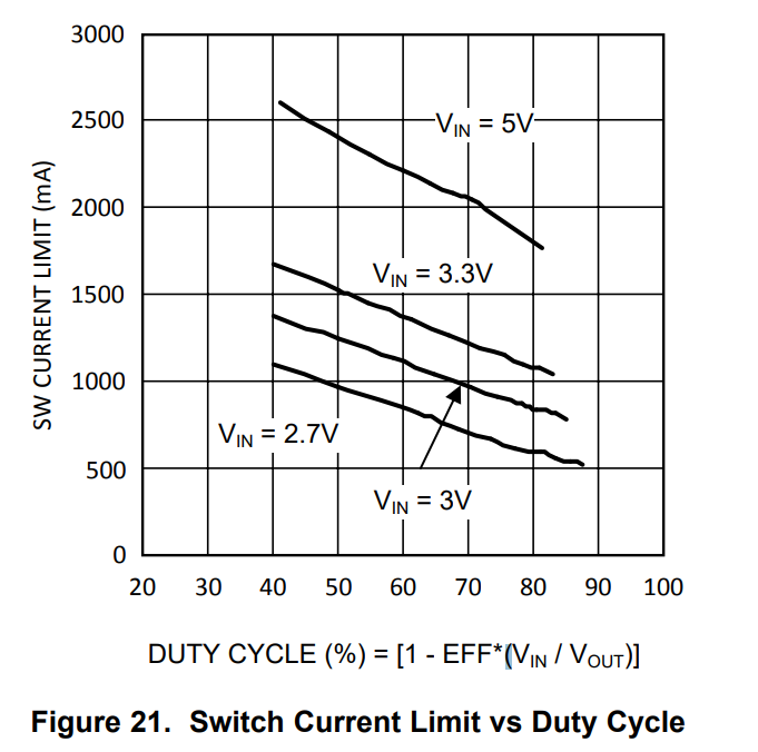

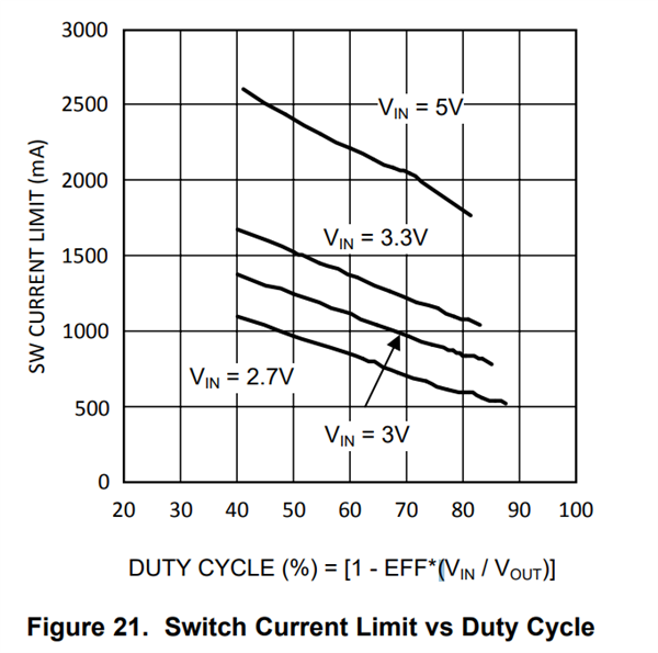

LMR62014: Vout is gradually decreasing at <3.5Vin
Part Number: LMR62014
Hi team,
The customer is using LMR62014 in the condition of 12Vin/15Vout as normal operation, but they observed that the output voltage is also gradually decreasing at <3.5Vin if the input voltage is gradually decreased as below.
12Vin --> 15Vout
10Vin --> 15Vout
5.0Vin --> 15Vout
3.3Vin --> 13.3Vout
3.0Vin --> 10.2Vout
2.7Vin --> 7.1Vout
The peripheral parameters are
- C1: 4.7uF
- L1: 10uH
- D1: MBR0520LT1G
- R1: 180kohm
- R2: 13.3k,ohm
- CF: 1000pF
- C2: 4.7uF
Could you tell us the reason the Vout is gradually decreasing at <3.5Vin along with the decrease of Vin?
