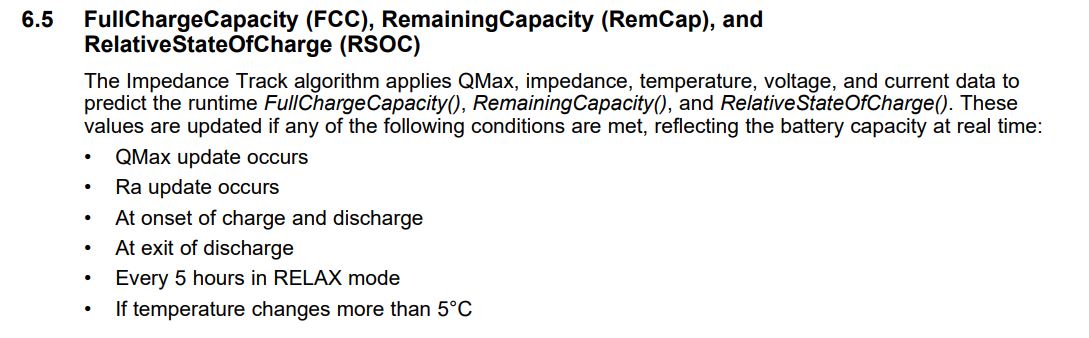

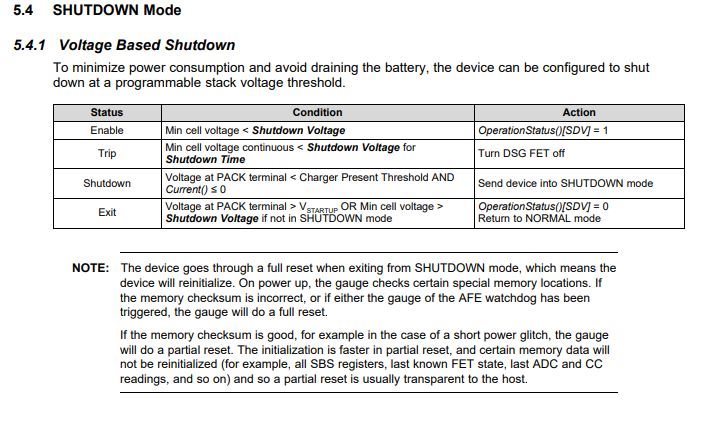

I am using the BQ28Z610 to monitor a LiFePO4 2S1P 4000mAh battery pack. I performed the learning cycle correctly as well as the a field update so the update status is set to 0x0E. After I charged the battery to full and that the Remaining Capacity and Full Charge Capacity fields update (CSYNC is set), averything looks good with a RSOC of 100% and a SOH of about 90%, which is Ok with me.
The problem is when I unplug the battery pack from the circuit and I replug it back in after a while, the BQ28Z610 has forgot what was the Full Charge and Remaining Capacity and just puts some random number going from 0mAh to the last learned Qmax. At this time, the device is sealed and ready for field used with cell balancing and everything.
EDIT: I just figured out that when I unplug-replug when the device is not sealed, I have a better approximation of what the capacity should be. It oscillates around a lower value than expected but it is way better than when the device is sealed. I use BQStudio to troubleshoot the parameters. Still, I would like to get the same (for the same temperature) Full Charge Capacity value as when I unplugged the battery pack.

My application necessitates that we prepare the system for production in factory but we need to unplug the batteries for storage and transport (we can't have them physically plugged in). So after doing things right and "pairing" the battery with the fuel gauge, everything resets when we plug the battery back since the BQ28Z610 reboots from complete shutdown. Is there a way to keep taht information stored somewhere? Or at least send a command that would set the Full Charge Capacity and Remaining Capacity fields to Qmax?
Xavier
  • It's a flash device, the FC and RemCap are computed. The FC bit gets set at primary charge termination. Refer to the TRM.
  • Kang Kang,
    I appreciate your answer. Here is what I found was helpful in the TRM:
    I agree that FCC and RemCap can recompute after any of these events happens. On the other hand, there is no information about what happens after a power cycle. Nowhere I could find information about that in the TRM. So on what parameters is FCC and RemCap computation based when the device comes back from a power cycle?
    The other thing is that the behaviour of FCC and RemCap computation after a power cycle is completely different for a sealed device and for an unsealed device. Why would that have anything to do with FCC and RemCap computation? I know that the flash is sealed, but does it mean that power cycling the device when the flash memory is sealed will just write random values in FCC and RemCap? That would be an issue since my TD and FD flags are based on RSOC and I rely on these flags for my higher level system logic. So when I plug in the battery and the FCC has randomly became 47mAh, it will take about 4min and the fuel gauge will give a RSOC of 0%, which will send an alarm to my servers...
    Here is the info about what happens to the memory after a power cycle, or shutdown (TRM):
    There is not a whole lot said here either. That is why I was hoping someone could help understand what is going on after a power cycle (plug-unplug battery).
    I can't say your answer has helped me much... can you be a bit more specific?
    Xavier
  • After a power cycle, the gauge, regardless of seal or unseal will take an OCV measurement. However, if there is current flowing, we will take an incorrect OCV. The gauge has some internal algorithm methods to try and correct for this bad initialization. These are all battery related behaviors.
    For seal and unseal, we reject reset command (0x41). That means in seal mode, an accidental reset will be rejected to prevent re-simulation of capacity.
    Does this help?
  • Kang Kang,
    Thank you for adding more information.
    So I understand that after the power cycle, there is always a reset (0x41) command issued. That explains the sealed/unsealed observation. I guess I will have to leave my devices unsealed, but that is not that much of a problem.
    So after a power cycle, the OCV reading is used to recompute FCC and RemCap. So depending on the voltage it reads, the FCC and RemCap values will vary accordingly, am I right? So in order to get a good FCC back, I need to wait for one of the events stated in section 6.5 of the TRM to happen if I understood correctly?
    Xavier
  • yes, power cycle and OCV reading is used to recompute RemCap and FCC. Your understanding is correct too.
