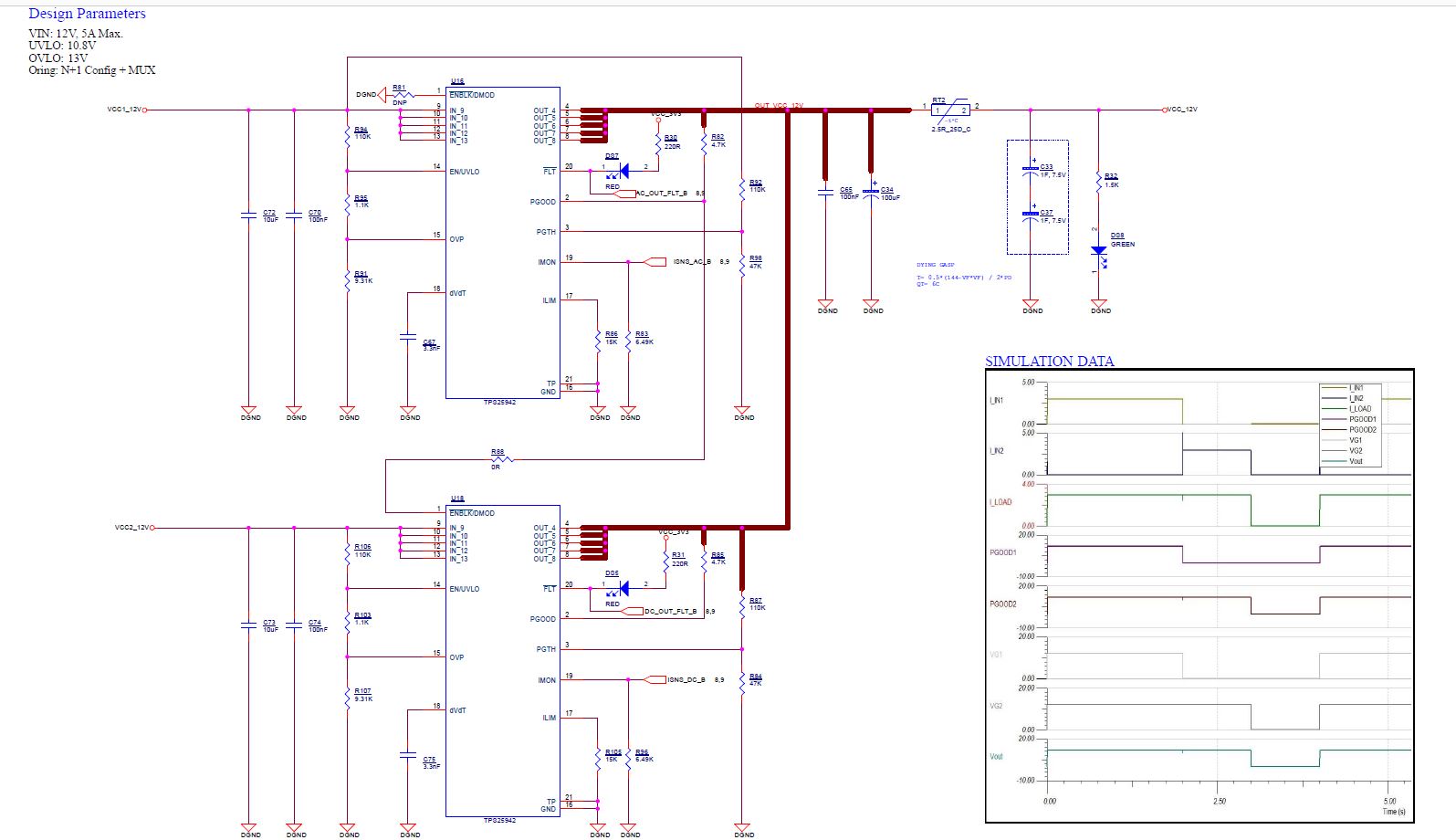

Hello Sir/Madam,

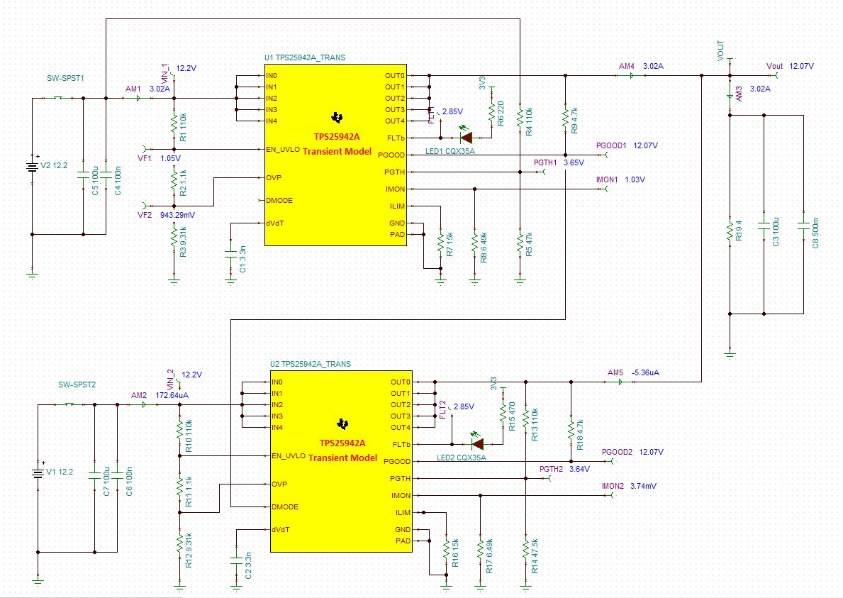

I have two 12V inputs with which I have designed a Power Muxing Circuit using TPS25942. (My goal is when both supplies are coming, Load should pull current from first TPS and when it goes off, Load should shift to second TPS. We have done simulation for same and is working according to my requirements.)
But in the actual board, When both Supplies are coming, ~FLT pin of the second TPS25942 is fluctuating.
We suspect it is something to do with UVLO pin of Second TPS25942. Another thing I observed is, In the datasheet, the OVLO pin of the second TPS25942 is grounded for MUX With Automatic and Seamless Switchover. WHY?
I am attaching my circuit and simulation file. Please go through it. And let us know how to fix it.
 TPS25942_automatic and seamless power muxing for almost same rail.TSC
