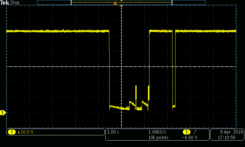

  • Hi Darwin Fernandez,
    I have got the reason for this inconsistency.
    As I have verified, PD can able to detect all the two event hardware detection requested by PSE.
    But, If we unplug and plug the cable very quickly (less than a second) in PSE side, it does not give the two event hardware detection signal on the PoE line, So, by default PD can indicate the Power as af mode (T2P pin active low indicates the at detection). This is the reason for the issue.

    1. Why PSE can not initiates the two event hardware detection if connect the cable back within very short period of time (less than a sec)? - Attached the image

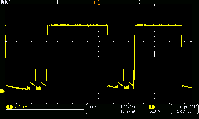

    3. I can see all the times it requires minimum of two times of Two event hardware detection required on the PoE line to classify the Class, Why its happening  and this is because of PSE or PD? - Attached the image
    Image - PSE not generating the two event hardware detection
    Image - Always required minimum 2 number of two event hardware detection happening
  • Hi Mariselvam,
    1. If the PSE sees a class current not within the Class 1,2,3,4 current range from the standard, then the PSE will default the PD to a Class 0 (13W). You can measure the current waveform as well during the class event to see what currents are present at that time.
    2. The TPS23754 should utilize the T2P pin for the load to know how much power was allocated to the PD. the load can then adjust the power whether its 13W or 25W. This is used so that an occasion like this one, where the PSE only allocates 13W, the PD won't try to output 25W because then the PSE will crash (overload).
    3. Majority of PSE controllers can be operated in different modes. This looks like semi-automode where a PSE will continuously do detection class but not turn ON. These PSEs like to know what's connected to it first and what power level so it can do power port management before turning ON and allocating a specific power level. In this case, the timing will depend on how the PSE is implementing the power management. This is NOT abnormal. Some designs I've seen do this cycle more than 2 times before powering up.
