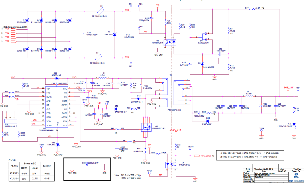

Further to the issue pertaining to making the changes to get a 28V output instead of 24V, i have made few changes in the feedback loop. Below are the changes that are done
1. R32 changed to 4.02K
2. R29 changed to 12K

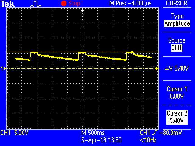

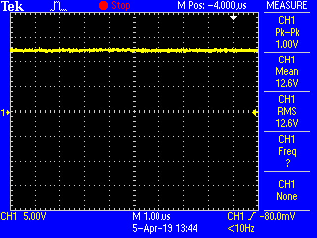

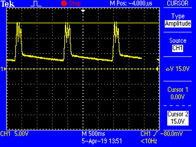

Also the VC voltage changes with and without load as shown below
1. Voltage at VC, without load
2. Voltage at VC, with load

  • Hi Sunil,
    I recommend changing the opto to FOD817A. It may be the CTR on your current design.
  • Hi Darwin,
    The change had been made earlier itself. Sorry that does not reflect in the schematics. We are using FOD817A (U3) on the board.
  • Okay I understand, next I recommend checking to see if the sense resistor is populated correctly on your board like it is on the schematic. It maybe that your converter is folding back early as you increase the load. Or I recommend decreasing the sense resistor.
  • Thanks Darwin, will try it out. Meanwhile do let me know how is the sense resistor value calculated. I followed the datasheet but i am not getting the proper value according to the design.

  • Hi Sunil,
    I just saw that the R29 you changed is the opto biasing current. 12k is too large. Can you try with 6.1k? This will keep is similar 4mA biasing current like it was with 24V.
  • Hi Darwin,
    Changed the R29 resistor to 6.1K (5.1K+1K in series). Still the same fluctuations exists when the rest of the circuit is connected. Just the POE section disconnected from the rest of the circuit works fine with output voltage constant at around 29V.

  • Okay. Next I would suggest that you look at some other critical signals. i would recommend looking at all of these together to see if there are any dependencies. you may need to play with zoom levels .
    * CTL
    * VB
    * VC

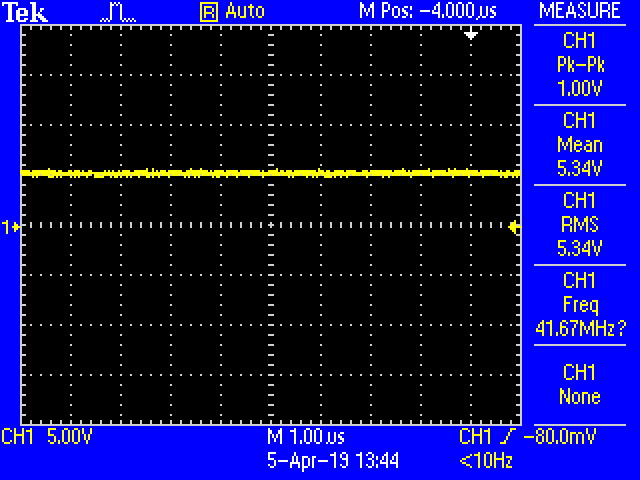

  • Hi Artem,
    During the issue, VB is fluctuating. Which may cause the CTL/output to fluctuate too, right ?. When the POE section is isolated (with no load on POE output) then VB is constant. Below are the graphs under both the cases
    1. VB - Without load
    2. VB - With Load
    What causes VB to fluctuate?
  • Sunil,
    Vb is derived from Vc with an internal linear regulator. From your previous waveforms we could see that the VCC was not stable. Thus I am not surprised that you are seeing this fluctuation on Vb.
    You need to look at VC, CTL, and Vb on the same scope shot to understand the cause and effect between these waveforms. It would be good to take a zoomed out scope picture and to also zoom in on when VCC is starting to drop off.
