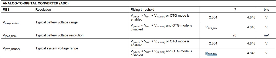

    One other thing that we see when we are discharging the battery, it is discharging to 2.8V, is it possible to set the MIN discharge voltage to 3.3V or 3.4V?
    For some reason when on battery the BQ25892 we see that the Vsys is < 3.5V (SYS_MIN) how is that possible ??
    In table on page 13 of DS is when Vvbus >Vbat -> min sys voltage is Vsys_min (3.5V) and see here a voltage down to 2.8V ?
    We measure Vbus= 0V and we have OTG pulled low and CE pulled low
    David.
  • Hi David,
    Unfortunately, the charger does not provide a battery discharge threshold. The charger expects the battery pack protector to provide over-
    discharge protection.
    When in MINSYS mode, if the buck converter has enough input power to drive both the system load and charge the battery, then V(SYS) = MINSYS. If not, and the battery must supplement the load, then V(SYS)=V(BAT)-ISUPP*RDSonQ4.
    The buck converter can only provide MINSYS voltage when VBUS is available.
    Jeff
  • Hi Jeff,
    if i understood correctly,
    1)
    when there is no VBUS and the device is operating only from battery then the min system voltage can  be as low as 2.8V ?
    2)
    the table on the page 13 is only valid when VBUS is present??
    3) why in this table there is Vsys_range when vbus<vbat, so this equation is not valid if vbus=0V ? and how much is the Vsys_min?
    4) is there similar charger to BQ25892 that has this the feature when on battery only? we want when the battery voltage drops to 3.4V or below to turn off the system.
    5) what do you suggest to use with BQ25892 in order to enable the feature?
    David.
  • Hi David,
    Regarding 1, with no VBUS, the BATFET between BAT and SYS will turn on down to V(BAT)=VBATDPL=2.15V-2.5V.
    Regarding 2 and 3, with no VBUS, the I2C bus only functions down to VBATUVLO=2.3V and the ADC only functions down to the MINSYS setting. MINSYS lowest setting is 3.0V.
    Regarding 4, none of our chargers with SYS (NVDC power path) have a UVLO/cutoff voltage that high. The chargers were designed assuming that the battery pack has a protector that opens at the desired discharge voltage.
    The BQ25892 has a bit that allows the host to turn off the BATFET. Can you write host software that uses the ADC to monitor the battery voltage and turn off the BATFET when V(BAT)=3.4V?
    BTW, if you do not need ISYS or ICHRG= 5A, only 3A, you can use the BQ25896, which is the 3A version of BQ25892.
    Jeff
