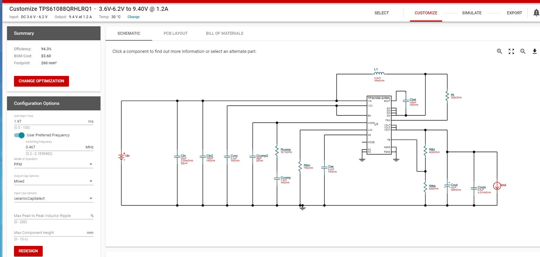

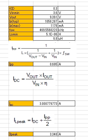

1. The inductance selection is calculated according to spec formula at least 5.1uH, but the inductance simulated by WEBENCH is 2.2uH. Which type should I choose?

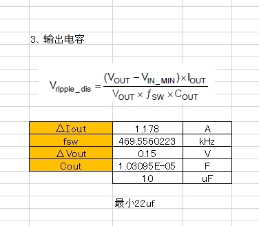

2. The selection of capacitance is calculated by spec formula at least 20uF, but the capacitance simulated by WEBENCH is 15+6.8uF. Which type should I choose?
