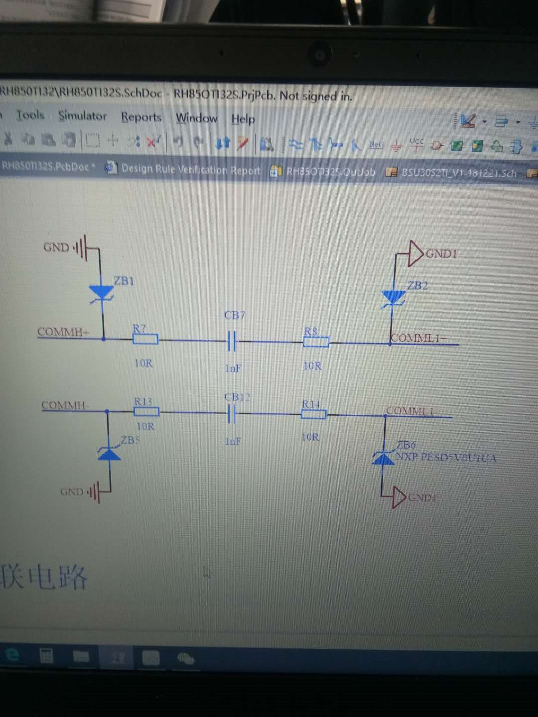

BQ76PL455A-Q1: Series communication between two Bq76pl455a-Q1 chips on the same board
Part Number: BQ76PL455A-Q1
xiaoming geng
Dears:
There are some troubles about series communication between two Bq76pl455a-Q1 chips on the same board.According to the manual about BQ76PL455AQ1,I made the following configuration about series communication.But the expected result did not appear, I am also not sure if there is an communication between the two chips.Please help me to check the configuration,and if it is incorrect please show me how to insolve this problem,ecpecte your response,thanks!
Best Regards!

  • Hi Xiaoming,
    Can you please explain what hardware you are using, is it our EVM board or custom? And please test your boards using our GUI first to check if the boards are working properly before moving towards custom software.
    Taylor
  • Hi Taylor,
    Thanks for your help.
    It is a custom board for one certain peoject with two BQ76PL455A-Q1 devices for 32 cells. I have made a successful board with one BQ76PL455A-Q1 for 16 cells before this and it works well. This matter is too urgent to test the EVM board with enough time.
  • Hi xiaoming,
    Ok, please test your custom hardware with our GUI and then our example mcu code if you are using a TMS570. That way we can tell if your hardware or software is at fault. Once you have verified if the GUI is working properly and recognizes both devices, then the second step would be to change your sw follow our auto address sequence exactly as in our software reference guide here: www.ti.com/.../slva617a.pdf
    Taylor
  • HI Taylor,
    Now there is such a sitiuation :the bottom stack device works well,but the top stack device do not response yet.I made the configuration with broadcast write command, they should have the same configuration.so if one responsed the right data,so did the other one.But the expected
    reusult din not appear.I can not find out what cause this,I hope you can help me to resolve this trouble.The software configuration is as above.The series communication circuit is as below screenshot,please help me to check if it is correct.
  • RH850TI32S.PDFTayor,
    First,thanks for your ansower with fully patient,thank you very much.There is an difference betwwen schematic and board ,i did not use the series fault sircuit thus it appears in the schematic,there is only comm circuit for using on the board,if it affect the result? Now my mcu is the renesas,does that mean i can not use the GUI for test?

    This file include my c code for software configuration ,please hlep to verify it.thanks!
  • Hi Xiaoming,
    Please test with the GUI if possible, you will have to bypass the mcu directly to the Rx/tx/wakeup/vcc/gnd pins using the FTDI cable so I am not sure if your board is capable to do so. Your autoaddressing code routine looks okay but it would be better to take our example code sequence exactly and test it that way. Also I do not see where you send the wakeup pulse. I do not fully understand your explanation of the failure for the top of stack board - does it respond to any commands ever or does it timeout?
    Taylor
  • Hi Taylor,
    I am afraid there is no condition for GUI to test my code routine accodring to that you said.wakeup pulse only exist in the bottom stackdevice,no existence in the top bottom stack device.I think the top stack device should be wakedup by daisy-chain signal from the bottom stack device,if it is true ?if there is no problem about both of schematic and code routine,the series communication should work well.so there must be some peoblem exist,I just could not find what the fault really is.It will be very thakful to let me know that whenever you find a way to solve it .Thanks for your help and patient reply.
  • Hi Talor,
    Thanks for you help again ,I have made a great progress with the issue of serial communication between two devices on the same board,It looks stable now.If I want to implement a new board that can sample 48 cells with three BQ76PL455A-Q1 devices,are there some deffirence between them, especially in communication and isolation power?What details should I pay attenion to?Thanks!
    Best regards
    xiaoming GENG
  • Hi Xiaoming,
    Glad to hear you were able to make progress! Would you mind sharing what your issue was to solve the communication problem? Mostly for 48 cells, it should be the same implementation for a 3rd device as your 2nd device that was stacked. Generally, in higher voltage BMS systems, we recommend to include a bridge only device as described in section 1.1 of our Use Case Scenarios app note but it is ultimately up to your preference and needs.
    Taylor
  • Hi Taylor,
    I did noting but soldered the chip once more ,so I feel the problem is that some pins of the chip is not soldered.Though it was just a simple error, it was the truth.I have never doubted it berore ,and I checked the code routine once and once,it also did't work normally,so I could do noting except soldered it again .surprised,it made an effect.Tough just a simple error ,however it was resolved  and I make a progress on my work and i can implemednt my next plan.Thanks again.
    xiaoming Geng
