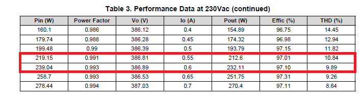

we will use UCC28064, but we find the UCC28064EVM-004 user`s guide test   230Vac performance Data of THD  9.89%
how to improve THD, be under 3%, at 230Vac
if any suggestion, Please advise me.
Lawrence.
  • Lawrence
    UCC28064EVM-004 is typical for expected THD performance that UCC28064A. Sub 3% THD is not possible with UCC28064A. To achieve such stringent THD performance we recommend that you use a digital controller like C2000.
