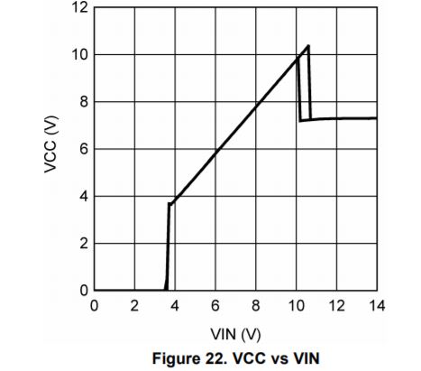

Can you confirm there's a direct connection from VIN to VCCX for below case:
VCCX is connected to VOUT with a 10 Ohm resistor.
VIN < 10.6V --> VIN is connected to VCC.
VCCX > 4.5V --> VCC is connected to VCCX
Thanks & BR,
KF
Can you confirm there’ll be a direct connection from VIN to VCCX for below case:
Like I described in my mail below VCCX is about 1,5V lower than VIN, which is about 8V. VCCX is connected to VOUT with a 10 Ohm resistor.
VIN < 10,6V --> VIN is connected to VCC
VCCX > 4,5V --> VCC is connected to VCCX
So in this case there is a direct connection form VIN to VCCX?
