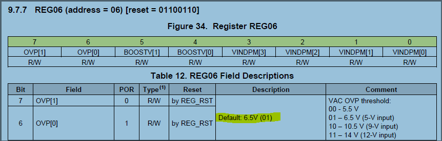

Could you pls help us check if BQ25601 have default OVP is 14V,my input is 12V. thanks!
Hi Angelo,
Input 12V,in default ovp 6.5v, battery no power. that ic can be in ovp. how to reg it.
thanks!
