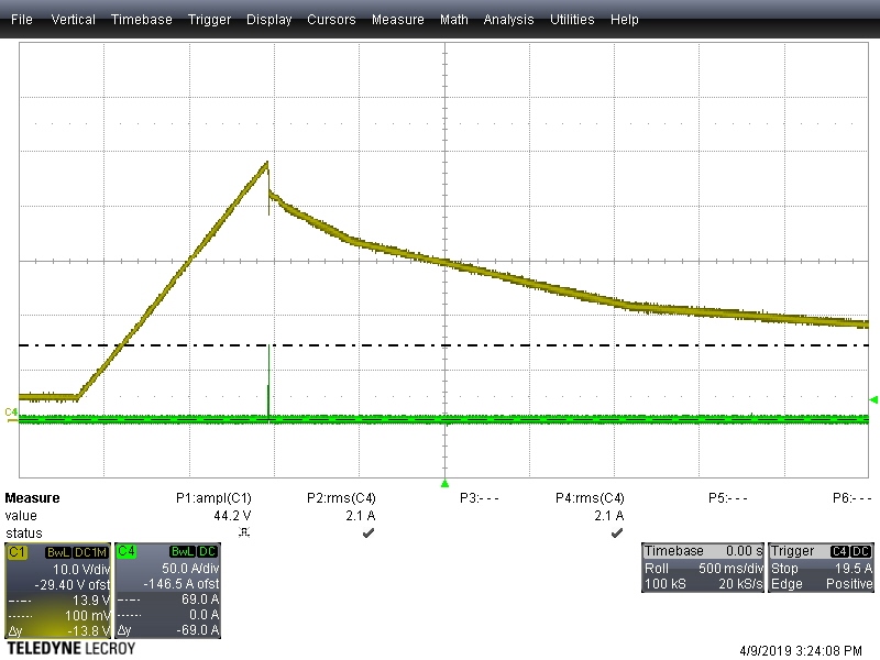

I attached waveform which is  measurement in transient peak current  when connect customer's product.  Even if that is normal operation our converter become shutdown because of peak current.
So could you plz some recommendation for reducing peak output current? as debugging some part in TI's IC such as soft start , PCM and so on.

  • Hello Kyeongmin
    Can you tell me what the two plots show please?.
    Can you also provide a plot of the voltage at the SS/EN pin during this event.
    I think that the controller is entering hiccup mode during the over current event. It is possible to increase the time delay before entering hiccup mode by increasing the capacitor at the SS/EN pin - this will also increase the soft start time. You can also use a pull up resistor from SS/EN to VREF to increase the time needed to enter hiccup mode. These options are explained in the document at.

  • Thank you for reply.
    I want to reduce output peak current.  I just wonder what relationship is between increasing OFF TIME and peak current ?
    --> yellow one is output voltage , green one is output current
    --> Sure , let me check after get customer set.

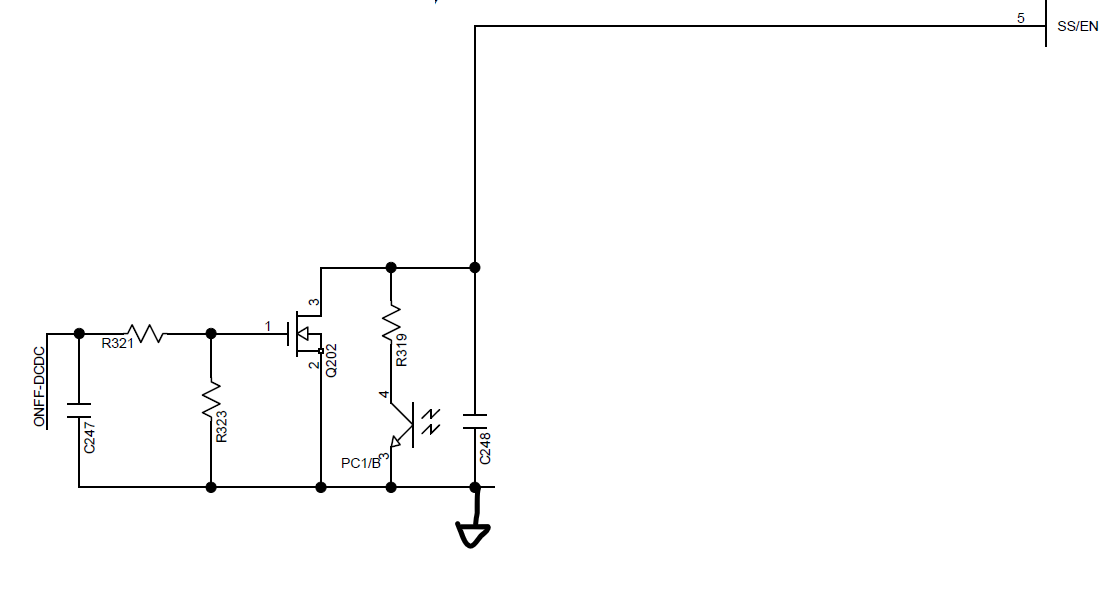

    This is our circuit of around ss/en pin.
    Could you plz tell us any advice. thank you
  • Hello Kyeongmin
    Thanks for identifying the two plots. So the customer product is connected and there is a large inrush current at that time. Is there a way to reduce the amplitude of this current and is this the expected level of current. There would also be a possibility that there is a spark as the customer unit is connected and this could cause long term damage.
    Please explain the function of the opto-coupler in the circuit above.
    I think that something is pulling the SS/EN pin low and that this is stopping the controller from switching. That is why I'd be interested to see the waveform at SS/EN.
