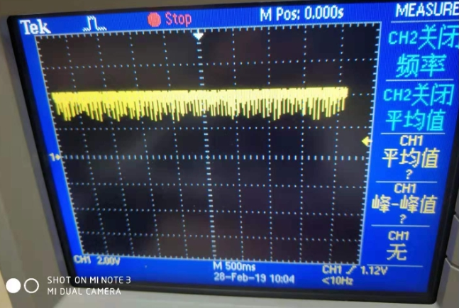

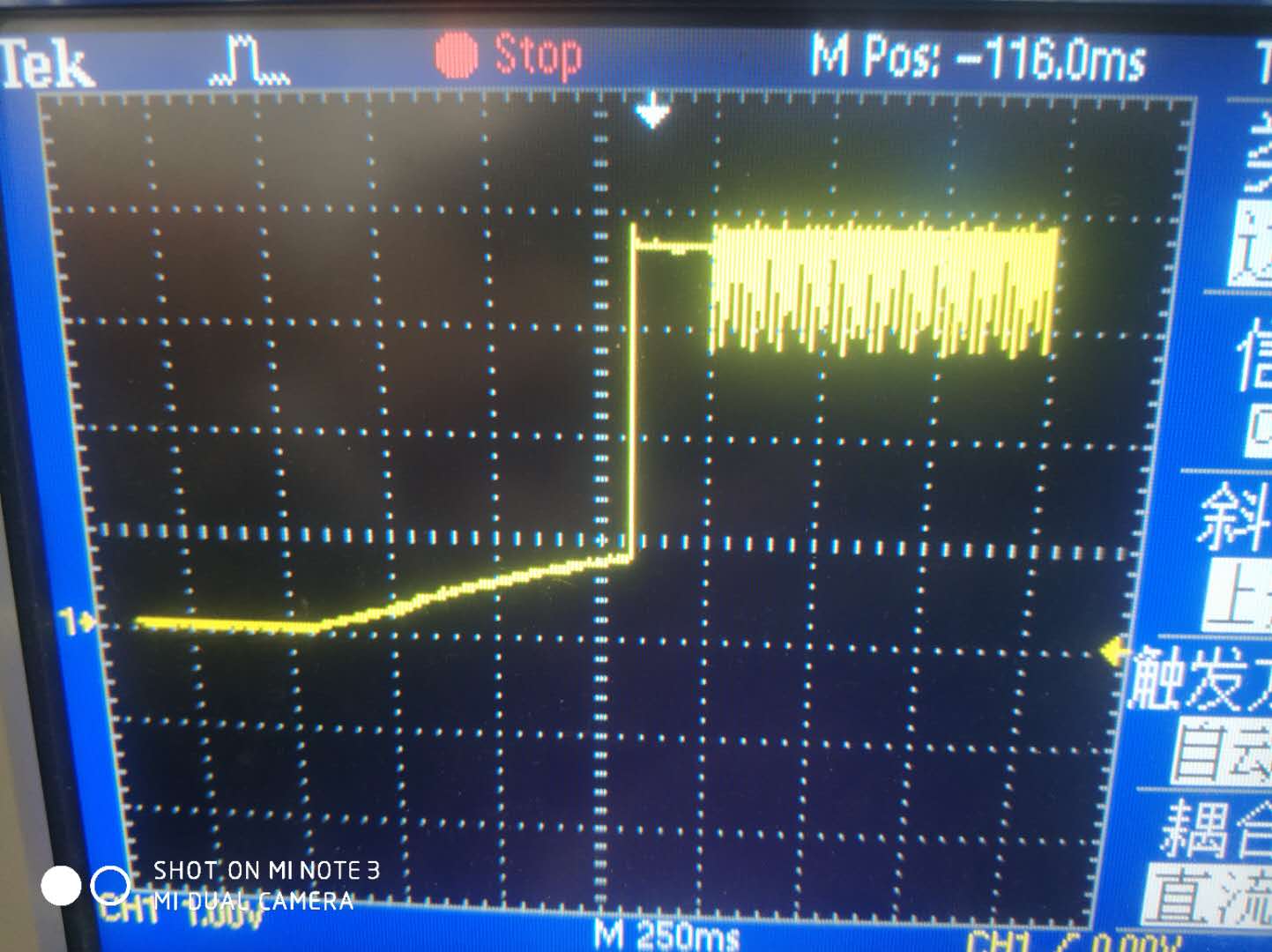

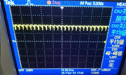

Because our design requires that the system should be able to start up normally even without battery. However, when the system is started up without battery, the output ripple of Vsys is very large, which directly leads to the abnormal output of PMIC voltage at the back end. The system cannot get up and the registers cannot be configured through I2C.
So we need a solution that allows the BQ24195L Vsys waveform to work properly (or not in PFM mode) without the battery and the register configuration.

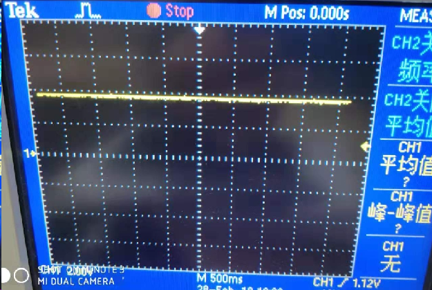

The Vsys waveform when BQ24195L power on without battery is below:
The Vsys waveform when BQ24195L power on with battery is below:
    When no battery is attached and charge is enabled by default, the charger sees the capacitor on BAT as a really small battery and goes through the normal stages of charging, termination, discharge then repeat. You can prevent this by disabling charge when the battery is removed.

    1. I force to pull the charge enable pin, /CE high to Vregn to disable the charger of BQ24195L.  When I plug in DC power to BQ24195L, the output of STAT pin is high which means the charger is disabled and the Vsys  output a 3.7V  for 200ms at first and then the ripple became huge which is absolutly abnormal.  what's the reason why this abnormal action happens?
