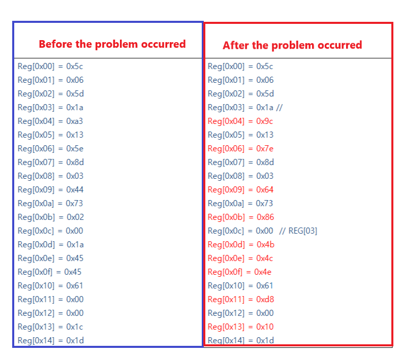

When comparing the register values ​​before and after the problem, it is confirmed that the BATFET_DIS bit of REG09 changes from 0 to 1 when a problem occurs.
Repeating the problem can be reproduced easily by repeatedly plugging and unplugging the charger.
At this time, I also confirmed that Iinlim 2.4A (0x5c) of Reg00 is set automatically.

In addition, the register values before and after the trouble occur are attached as follows.

  • Anthony,
    1.When ILIM pin is short, the input current limit is set by the register.
    2. What is ISYS profile? Please note that when the system is overloaded or shorted (IBAT > IBATFET_OCP), the device turns off BATFET immediately and set BATFET_DIS bit to indicate BATFET is disabled until the input source plugs in again or one of the methods describe in BATFET Enable (Exit Shipping Mode) is applied to re-enable BATFET.
    Ning.
