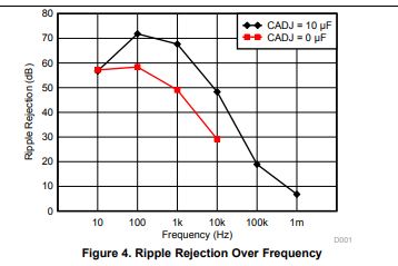

Hi Yokota,
Cadj should be placed in parallel to R2. Below please find an example schematic from the similar LM337-N datasheet. The LM337-N is a very similar device that was released by National Semiconductor before the TI acquisition.
A 10 uF Cadj will improve the PSRR as shown in Figure 4:
